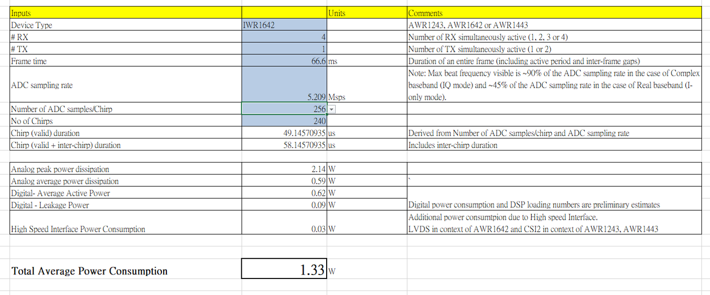

I found the EXCEL file(TI_Radar_power_calculator_for_Industrial_v0p7) that can calculate the AWR1642 power consumption.
There are some question about the tool:
1. what's the "No of chirps" means in the c18?

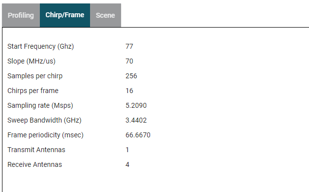

2.Can i found the the matching parameters in the mmWave Demo Visualizer  showed in the follow?
