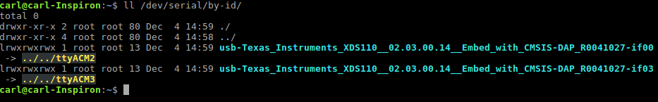

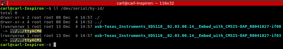

I'd like to do the following: Run two of the same boards (in this case two AWR1642BOOST boards) simultaneously in the ROS environment.
I'm running into the following problems when connecting both boards:
  • When I connect the first AWR1642BOOST, I get the following output from: ll /dev/serial/by-id
This is what I would expect having a single board plugged in. The serial ID may change from board to board. For instance, the serial ID for the IWR1642BOOST is:
usb-Texas_Instruments_XDS110__02.03.00.12__Embed_with_CMSIS-DAP_R0051028-if0x
  • When I connect the second board, I get the following output from: ll /dev/serial/by-id
As you can see, both boards have the exact same serial ID, and thus the first board (connected to /dev/ttyACM0 and /dev/ttyACM1)  disappears from the list.
How can I use both boards at the same time? Do I need to remap the serial names assigned to each device? Or is there another method for uniquely identifying each board?
