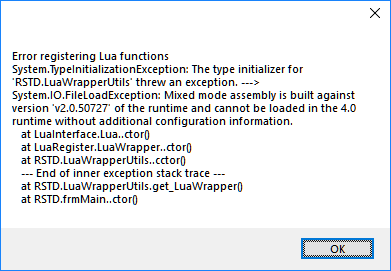

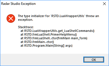

  • We set up a VM over the weekend and tried again to install mmWave Studio.  We successfully installed the mmwave_studio_02_00_00_02_win32 executable, the FTDI drivers, the MS C++ runtime, and the MatLab runtime.  Running the mmWave Studio executable as administrator, we get a "Error registering Lua functions" error + exception, see below.
    Again, our reason for installing mmWave Studio is to gain access to the Radar API calculator, in the hope that it will provide useful configuration values for the mmWave SDK 3.00.00.08.  We don't need mmWave Studio for data acquisition, at least for now.

  • Image was not attached to the last post, here it is:
  • Hi Dan,
    We have not tested MMWAVE-STUDIO on a VM. I would request you to install it on a native Windows machine along-with the required tools mentioned in the user guide for MMWAVE-STUDIO 2.0.0.2. You need to install only MMWAVE-STUDIO and the Matlab Runtime and additionally Visual C++ 2013 Redistributable if installing on Windows 10.

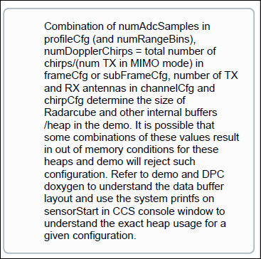

  • Hi Dan,
    Sorry for the delay. The mmWave Sensing Estimator generates values according to the RF front-end capabilities of the selected device i.e. what is possible with the device (while also generating information useful for designing the digital processing chain such as Radar cube memory, FFT size etc), while the mmWave SDK Demo has been tested with a sub-set of configurations. This means that not all configurations generated using the mmWave Sensing Estimator may work with the SDK demos. The SDK demos show only one possible processing chain and do not claim to be a processing chain which can process all possible use-cases. In other words, the configurations generated using the Sensing estimator are a Super-set of what is supported by the SDK demos.
    The MMWAVE-SDK 3.0.0.8 user guide also mentions this in the following note:
