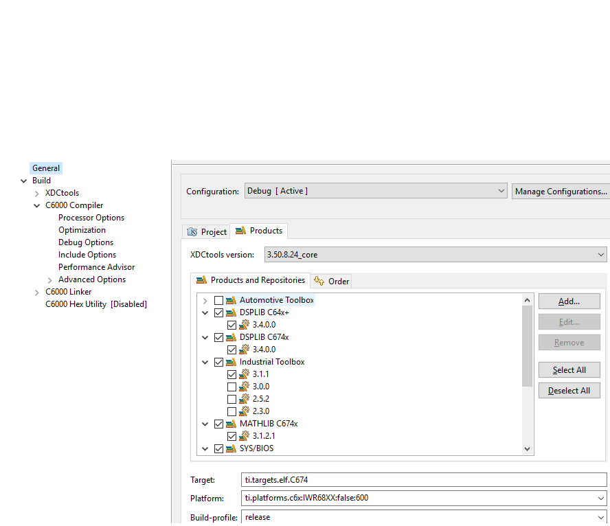

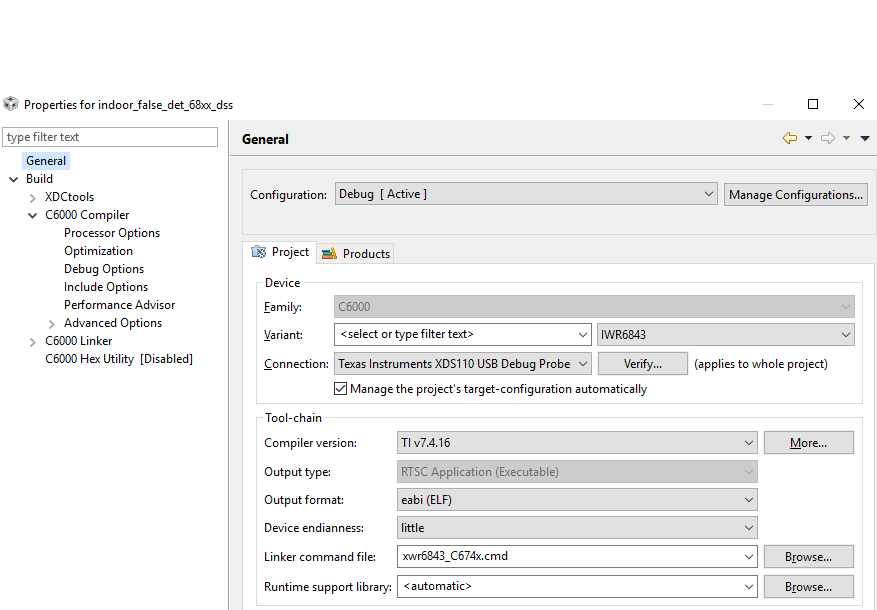

I am using thr IWR6843 EVM .
The board functions well when examining the provided bin files of the labs (mmwave_industrial_toolbox_3_1_1__win)
I want to compile the lab22 of this toolbox.
I've followed the requirements for setting the ccs environment.
Still when compiling the DSS ,there's rejection.
Detailed information:
1.Code Composer Studio: Version: 8.2.0.00007
2.Configurations
2.1.DSS:
compiler v7.4.16
build
pre-build steps
rm -f ${PROJECT_ROOT}/${ProjName}.bin
post-build steps
${COM_TI_MMWAVE_SDK_INSTALL_DIR}/packages/scripts/ImageCreator/out2rprc/out2rprc.exe ${ProjName}.xe674 ${ProjName}.bin
XDCtools
--xdcpath="C:/ti/bios_6_73_01_01/packages;C:/ti/dsplib_c64Px_3_4_0_0/packages;C:/ti/dsplib_c674x_3_4_0_0/packages;C:/ti/mathlib_c674x_3_1_2_1/packages;" xdc.tools.configuro -o configPkg -t ti.targets.elf.C674 -p ti.platforms.c6x:IWR68XX:false:600 -r release -c "C:/ti"
c6000 compiler
-mv6740 --abi=eabi -O3 -ms0 -g --include_path="C:/Users/Gil.Albo/workspace_v8_PPLCOUNt_sdk_3_0_0_indust_3_1_1/indoor_false_det_68xx_dss" --include_path="C:/Users/Gil.Albo/workspace_v8_PPLCOUNt_sdk_3_0_0_indust_3_1_1/indoor_false_det_68xx_dss/dss" --include_path="C:/ti/mmwave_sdk_03_00_00_08/packages" --include_path="C:/ti/mathlib_c674x_3_1_2_1/packages" --include_path="C:/ti/dsplib_c674x_3_4_0_0/packages/" --include_path="C:/ti/dsplib_c64Px_3_4_0_0/packages/" --include_path="C:/ti/dsplib_c64Px_3_4_0_0/packages/ti/dsplib/src/DSP_fft16x16_imre/c64P" --include_path="C:/ti/dsplib_c674x_3_4_0_0/packages/ti/dsplib/src/DSPF_sp_fftSPxSP" --include_path="C:/ti/dsplib_c64Px_3_4_0_0/packages/ti/dsplib/src/DSP_fft32x32/c64P" --include_path="C:/ti/mmwave_industrial_toolbox_3_1_1__win/mmwave_industrial_toolbox_3_1_1/labs/lab0022_indoor_false_det_68xx/src/mss/gtrack" --include_path="C:/ti/mmwave_industrial_toolbox_3_1_1__win/mmwave_industrial_toolbox_3_1_1/labs/lab0022_indoor_false_det_68xx/src/common" --include_path="C:/ti/mmwave_industrial_toolbox_3_1_1__win/mmwave_industrial_toolbox_3_1_1/labs/lab0022_indoor_false_det_68xx/src" --include_path="C:/ti/include" --gcc --define=SOC_XWR68XX --define=GTRACK_2D --define=SUBSYS_DSS --define=MMWAVE_L3RAM_NUM_BANK=6 --define=MMWAVE_SHMEM_TCMA_NUM_BANK=0 --define=MMWAVE_SHMEM_TCMB_NUM_BANK=0 --define=MMWAVE_SHMEM_BANK_SIZE=0x20000 --define=DOWNLOAD_FROM_CCS --define=DebugP_ASSERT_ENABLED --define=_LITTLE_ENDIAN --diag_wrap=off --display_error_number --diag_warning=225 --gen_func_subsections=on --obj_extension=.oe674
c6000 linker
-mv6740 --abi=eabi -O3 -ms0 -g --gcc --define=SOC_XWR68XX --define=GTRACK_2D --define=SUBSYS_DSS --define=MMWAVE_L3RAM_NUM_BANK=6 --define=MMWAVE_SHMEM_TCMA_NUM_BANK=0 --define=MMWAVE_SHMEM_TCMB_NUM_BANK=0 --define=MMWAVE_SHMEM_BANK_SIZE=0x20000 --define=DOWNLOAD_FROM_CCS --define=DebugP_ASSERT_ENABLED --define=_LITTLE_ENDIAN --diag_wrap=off --display_error_number --diag_warning=225 --gen_func_subsections=on --obj_extension=.oe674 -z --stack_size=0x800 -m"indoor_false_det_68xx_dss.map" --heap_size=0x800 -i"C:/ti/lib" -i"C:/Users/Gil.Albo/workspace_v8_PPLCOUNt_sdk_3_0_0_indust_3_1_1/indoor_false_det_68xx_dss" -i"C:/ti/mmwave_sdk_03_00_00_08/packages/ti/control/mmwave/lib" -i"C:/ti/mmwave_sdk_03_00_00_08/packages/ti/control/mmwavelink/lib" -i"C:/ti/mmwave_sdk_03_00_00_08/packages/ti/alg/mmwavelib/lib" -i"C:/ti/mmwave_sdk_03_00_00_08/packages/ti/drivers/crc/lib" -i"C:/ti/mmwave_sdk_03_00_00_08/packages/ti/drivers/mailbox/lib" -i"C:/ti/mmwave_sdk_03_00_00_08/packages/ti/drivers/soc/lib" -i"C:/ti/mmwave_sdk_03_00_00_08/packages/ti/drivers/osal/lib" -i"C:/ti/mmwave_sdk_03_00_00_08/packages/ti/drivers/uart/lib" -i"C:/ti/mmwave_sdk_03_00_00_08/packages/ti/drivers/edma/lib" -i"C:/ti/mmwave_sdk_03_00_00_08/packages/ti/drivers/adcbuf/lib" -i"C:/ti/dsplib_c674x_3_4_0_0/packages/ti/dsplib/lib" -i"C:/ti/dsplib_c64Px_3_4_0_0/packages/ti/dsplib/lib" -i"C:/ti/mathlib_c674x_3_1_2_1/packages/ti/mathlib/lib" -i"C:/ti/mmwave_industrial_toolbox_3_1_1__win/mmwave_industrial_toolbox_3_1_1/labs/lab0022_indoor_false_det_68xx/src/mss/gtrack/lib" -i"C:/ti/include" --reread_libs --disable_auto_rts --define=MMWAVE_L3RAM_NUM_BANK=6 --define=MMWAVE_SHMEM_TCMA_NUM_BANK=0 --define=MMWAVE_SHMEM_TCMB_NUM_BANK=0 --define=MMWAVE_SHMEM_BANK_SIZE=0x20000 --diag_warning=225 --display_error_number --warn_sections --diag_wrap=off --xml_link_info="xwr16xx_indoor_false_det_68xx_dss_linkInfo.xml" --ram_model --unused_section_elimination=on
2.2.MSS
pre build steps
rm -f ${PROJECT_ROOT}/indoor_false_det_68xx_lab.bin
post build steps
${COM_TI_MMWAVE_SDK_INSTALL_DIR}/packages/scripts/ImageCreator/out2rprc/out2rprc.exe ${ProjName}.xer4f ${ProjName}.bin
${COM_TI_MMWAVE_SDK_INSTALL_DIR}/packages/scripts/ImageCreator/multicore_image_generator/MulticoreImageGen.exe LE 37 0x02000006 indoor_false_det_68xx_lab.bin 0x35510000 ${ProjName}.bin 0xb5510000 ${COM_TI_MMWAVE_SDK_INSTALL_DIR}/firmware/radarss/iwr6xxx_radarss_rprc.bin 0xd5510000 ${WORKSPACE_LOC}/indoor_false_det_68xx_dss/Debug/indoor_false_det_68xx_dss.bin
${COM_TI_MMWAVE_SDK_INSTALL_DIR}/packages/scripts/ImageCreator/crc_multicore_image/crc_multicore_image.exe indoor_false_det_68xx_lab.bin indoor_false_det_68xx_lab.bin.tmp
${COM_TI_MMWAVE_SDK_INSTALL_DIR}/packages/scripts/ImageCreator/append_bin_crc/gen_bincrc32.exe indoor_false_det_68xx_lab.bin
XDCtools
--xdcpath="C:/ti/bios_6_73_01_01/packages;" xdc.tools.configuro -o configPkg -t ti.targets.arm.elf.R4F -p ti.platforms.cortexR:IWR68XX:false:200 -r release -c "C:/ti/ti-cgt-arm_16.9.6.LTS" --compileOptions "--enum_type=int "
ARMcompiler
-mv7R4 --code_state=16 --float_support=VFPv3D16 -me -O3 --include_path="C:/Users/Gil.Albo/workspace_v8_PPLCOUNt_sdk_3_0_0_indust_3_1_1/indoor_false_det_68xx_mss" --include_path="C:/ti/mmwave_sdk_03_00_00_08" --include_path="C:/ti/mmwave_sdk_03_00_00_08/packages" --include_path="C:/ti/mmwave_industrial_toolbox_3_1_1__win/mmwave_industrial_toolbox_3_1_1/labs/lab0022_indoor_false_det_68xx/src/mss/gtrack" --include_path="C:/ti/mmwave_industrial_toolbox_3_1_1__win/mmwave_industrial_toolbox_3_1_1/labs/lab0022_indoor_false_det_68xx/src/common" --include_path="C:/ti/mmwave_industrial_toolbox_3_1_1__win/mmwave_industrial_toolbox_3_1_1/labs/lab0022_indoor_false_det_68xx/src" --include_path="C:/ti/ti-cgt-arm_16.9.6.LTS/include" --define=_LITTLE_ENDIAN --define=SOC_XWR68XX --define=GTRACK_2D --define=SUBSYS_MSS --define=DOWNLOAD_FROM_CCS --define=MMWAVE_L3RAM_NUM_BANK=6 --define=MMWAVE_SHMEM_TCMA_NUM_BANK=0 --define=MMWAVE_SHMEM_TCMB_NUM_BANK=0 --define=MMWAVE_SHMEM_BANK_SIZE=0x20000 --define=DebugP_ASSERT_ENABLED --define=APP_RESOURCE_FILE='<'ti/demo/xwr68xx/mmw/mmw_res.h'>' -g --c99 --diag_warning=225 --diag_wrap=off --display_error_number --gen_func_subsections=on --enum_type=int --abi=eabi --obj_extension=.oer4f
ARMlinker
-mv7R4 --code_state=16 --float_support=VFPv3D16 -me -O3 --define=_LITTLE_ENDIAN --define=SOC_XWR68XX --define=GTRACK_2D --define=SUBSYS_MSS --define=DOWNLOAD_FROM_CCS --define=MMWAVE_L3RAM_NUM_BANK=6 --define=MMWAVE_SHMEM_TCMA_NUM_BANK=0 --define=MMWAVE_SHMEM_TCMB_NUM_BANK=0 --define=MMWAVE_SHMEM_BANK_SIZE=0x20000 --define=DebugP_ASSERT_ENABLED --define=APP_RESOURCE_FILE='<'ti/demo/xwr68xx/mmw/mmw_res.h'>' -g --c99 --diag_warning=225 --diag_wrap=off --display_error_number --gen_func_subsections=on --enum_type=int --abi=eabi --obj_extension=.oer4f -z -m"indoor_false_det_68xx_mss.map" --heap_size=0x800 --stack_size=0x800 -i"C:/ti/ti-cgt-arm_16.9.6.LTS/lib" -i"C:/ti/mmwave_sdk_03_00_00_08/packages/ti/control/mmwave/lib" -i"C:/ti/mmwave_sdk_03_00_00_08/packages/ti/control/mmwavelink/lib" -i"C:/ti/mmwave_sdk_03_00_00_08/packages/ti/drivers/crc/lib" -i"C:/ti/mmwave_sdk_03_00_00_08/packages/ti/drivers/dma/lib" -i"C:/ti/mmwave_sdk_03_00_00_08/packages/ti/drivers/esm/lib" -i"C:/ti/mmwave_sdk_03_00_00_08/packages/ti/drivers/gpio/lib" -i"C:/ti/mmwave_sdk_03_00_00_08/packages/ti/drivers/mailbox/lib" -i"C:/ti/mmwave_sdk_03_00_00_08/packages/ti/drivers/osal/lib" -i"C:/ti/mmwave_sdk_03_00_00_08/packages/ti/drivers/pinmux/lib" -i"C:/ti/mmwave_sdk_03_00_00_08/packages/ti/drivers/soc/lib" -i"C:/ti/mmwave_sdk_03_00_00_08/packages/ti/drivers/uart/lib" -i"C:/ti/mmwave_sdk_03_00_00_08/packages/ti/utils/cli/lib" -i"C:/ti/mmwave_industrial_toolbox_3_1_1__win/mmwave_industrial_toolbox_3_1_1/labs/lab0022_indoor_false_det_68xx/src/mss/gtrack/lib" -i"C:/ti/ti-cgt-arm_16.9.6.LTS/include" --reread_libs --disable_auto_rts --define=MMWAVE_L3RAM_NUM_BANK=6 --define=MMWAVE_SHMEM_TCMA_NUM_BANK=0 --define=MMWAVE_SHMEM_TCMB_NUM_BANK=0 --define=MMWAVE_SHMEM_BANK_SIZE=0x20000 --diag_warning=225 --diag_wrap=off --display_error_number --warn_sections --xml_link_info="indoor_false_det_68xx_mss.xml" --rom_model --unused_section_elimination=on

  • Former Member
    0 Former Member
    Hello Gil,
    Can you check that your project includes match the paths as shown here:
    If there are any discrepancies please resolve them so that they match what is shown. Then try importing the project into a new workspace and compiling.
    Amanda
  • Hi Amanda,
    thank you for the reply.
    I'm using the windows environment (not linux)
    brThe c6000 doesn't appear at my workspace (include part)
    please direct me how to add this to the path.
    BR
    Gil
  • Former Member
    0 Former Member in reply to gil albo
    Gil,
    I see from your previous screenshots that you have already installed the 7.4.16 compiler?
    If yes, then I think the issue is that you need to do a clean import of the project.
    You can either open a new workspace and import the project or right click on the project and select delete. Make sure to check the box for 'delete project contents on disk'.
    Amanda
  • Hi Amanda,
    This didn't work.
    I created new project and imported the lab again.
    Followed all the requirements as appear at the user guide.
    Still, the error appear during compilation of the dss.
    The proejct is indoor_false_det_68xx at lab 22
    C:\ti\mmwave_industrial_toolbox_3_1_1__win\mmwave_industrial_toolbox_3_1_1\labs\lab0022_indoor_false_det_68xx\docs
    At the project explorer, the include section doesn't contain the c6000
    please direct me, to solve this.
    Here's the error message:
