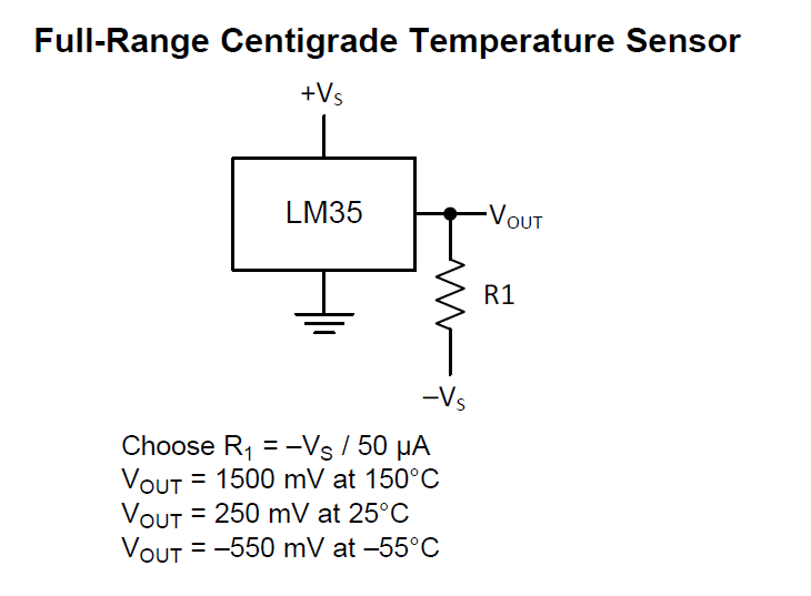

Customer wants to understand some detail of how to design with LM35, please kindly help, thanks.
The temperature range need is -40 ~ 90 C.
(1) When we connect like below, The -Vs is directly impact the accuracy of output?
2. When we connect like below, it's a differential output and it still follows the same 10mV/C relationship, correct?
3. Any special cares for the diode we choose?
4. Comparing with LM135 design for same temperature range -40 ~ 90 C. Can we follow circuit like above to make it differential output with single supply? Thanks.
Andrew
Hello Andrew,
1) Vs does not directly affect the output; in all cases it is defined as 10 mV/C (independent of Vs). The accuracy given in the datasheet is based on a Vs of 5V.
2) Yes, the relationship is the same.
3) The diodes both have Vf of 1-V which is plenty of room for the negative rail of Vout, which goes down to -400 mV.
4) If you are using a single supply, you will use the configuration shown in Figure 18 to create a negative voltage with respect to ground, and use a differential measurement.
Please check out the TMP235, which TI recommends as a high-accuracy analog temperature sensor which works with a single-ended supply and has 10 mV/C sensor gain. You do not need the diodes or a negative supply rail to use this part to sense the entire temperature range.
