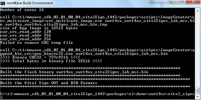

I'm porting vital signs demo from SDK version 1.2 to SDK 2.1 version. As, I added project successfully and built it. While build it cleans xx_demo.bin file, and throws error like fails to clean crc file. At end build there is no bin file.
Please find attached screenshot of build.

    The error "Failed to remove CRC temp file" is a warning that you can ignore. From the screenshot, there don't seem to be any other errors that were generated - the .bin seems to have been generated correctly.
    (Otherwise I would have expected the gen_bincrc32.exe call to have failed).
    Can you please double check and confirm that the .bin file is not there?
