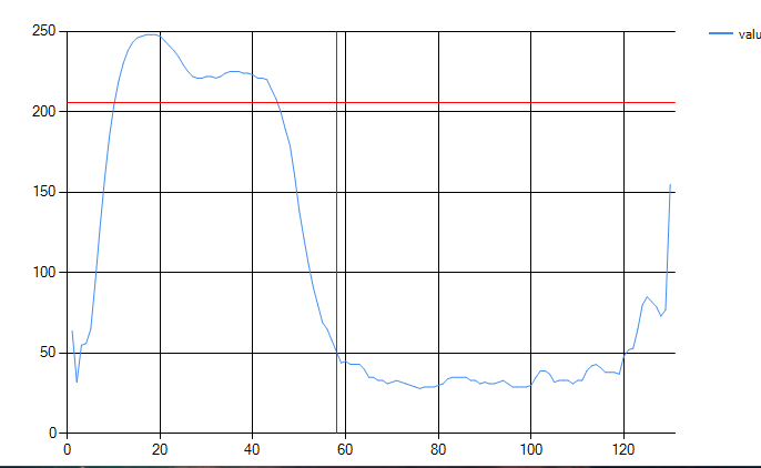

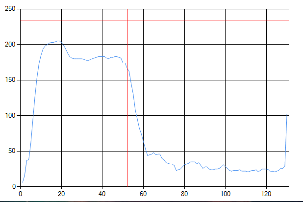

After evaluating PGA460, we decided to make PCB to evaluate the operation status of multiple PGA460.However, after configuring them separately, we found that Echo Data Dump results of some chips were not what we expected.The peak value of the vibration attenuation is obviously smaller than the normal case.
The PCB includes the peripheral circuit of PGA460 and a TTL protocol to RS232 protocol conversion circuit.Use STM32 MCU UART drive it.The 12 v power supply.
The following are the configuration parameters of PGA460.
From 15H to 2AH:{0xAF,0XFF,0XFF,0X2D,0X68,0X36,0X5C,0X8A, 0X0F,0X03,0X12,0X68,0X51,0X03,0X00,0XEE,0X7C,0X0A,0X00,0X00,0X08,0X00}
            Abnormal ECHO DATA DUMP DATA image(Use preset 1 for burst and listening)
                        The normal ECHO DATA DUMP DATA image(Use preset 1 for burst and listening)
We have tried switching between normal and abnormal modules, but the result is the same as before.And I tried to replace some components on the PCB, but there was still no result.
For this, can we try to use two different PGA460 devices to drive the same transducer?That is, use abnormal module to issue only listening instruction, use another normal module to issue burst and listening instruction, or vice versa (in the case of directly connecting the transducer pin on the corresponding PCB).

    Did you use the PGA460-Q1 EVM and GUI to initially evaluate the PGA460? If so, is the echo data dump performance consistent and match to what you have shown above?
    If I understand the error correctly, you are comparing the performance of two independent PGA460 modules, both of which have the same hardware and register configuration, but are returning different echo data dump performance results. As you suggested, have you tried swapping the transducers between the two modules to determine if it is the transducers that are at fault for the performance variation?
  • Thank you for your opinion. After the test, it can be confirmed that the phenomenon is caused by the transducer.We found that we could change the frequency of the transducer to get the result I wanted.Specifically, between 56khz and 59khz, transducers are activated one by one and echo data is collected until sufficient ideal waveform results are obtained.The ported autoThreshold function is then run, but the effect is not ideal within the preset range.I would like to ask if there is a more reliable solution.At the same time, how should I determine whether the object being detected is in the blind area of close range (0-25cm in our application) or outside the detection range (we set the value to 255cm)?

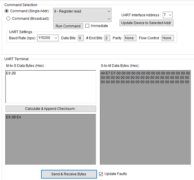

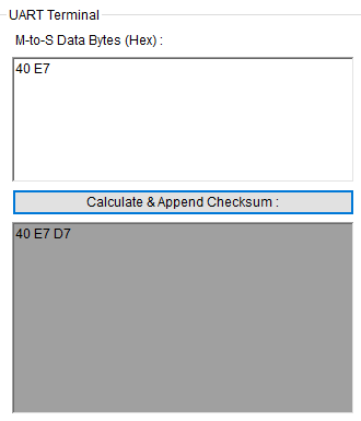

    Can you please provide an example of the return data + erroneous_checksum returned by the UART_ADDR=4-7 device which does no match your calculated return checksum? I've checked a few examples using the PGA460-Q1 EVM/GUI, and cannot replicate this error. Example: UART_ADDR = b111 (0x7) performing a register read of address 0x2B. PGA460 returns 0x{40 E7 D7}, where:
    • diagnostic field = 0x40
    • data at address = 0xE7
    • device calculated checksum = 0xD7
    Passing byte array 0x{40 E7} into the checksum calculator returns matching value of 0xD7.
    Executing register read command Verifying device generated checksum
