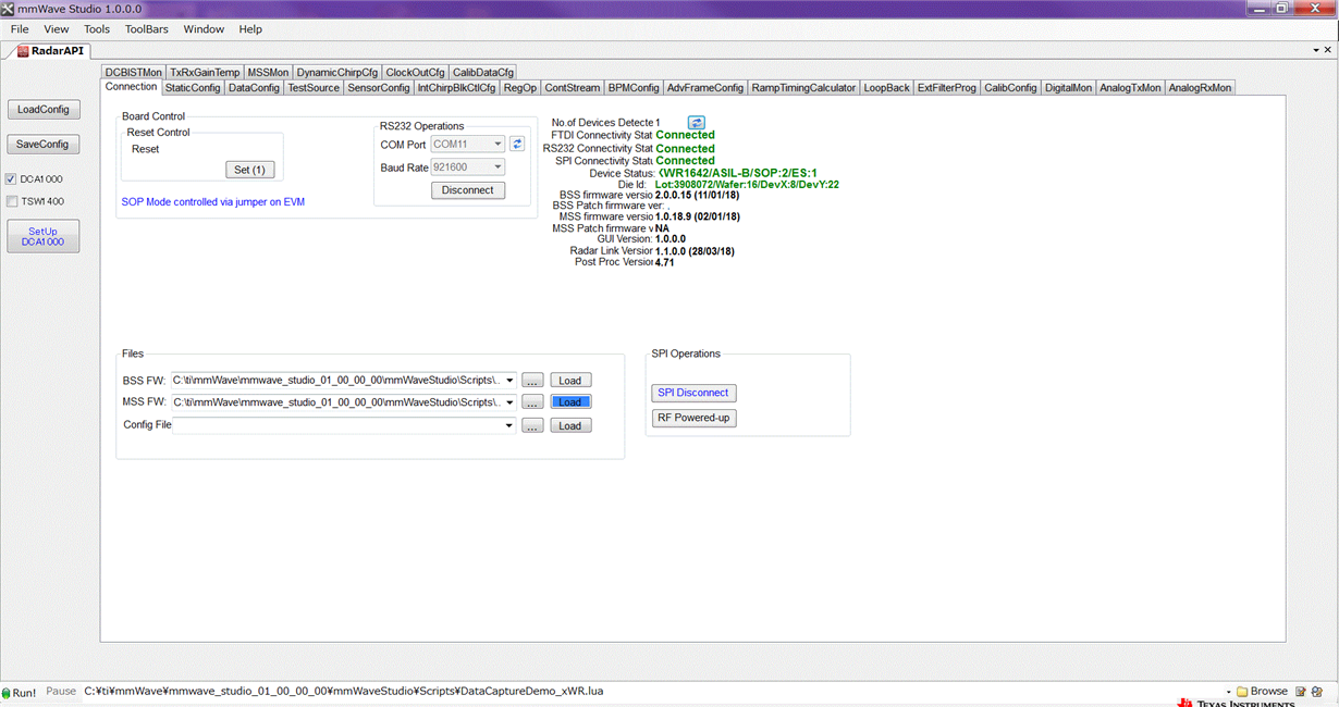

Dear support team;
I connected AWR1642BOOST and DCA1000.
And I ran mmwave-studio and read DataCaptureDemo_xWR.lua
But I cannot get the GUI.
Maybe, this script was stopping at [RF Powered-up].
Could you help me?
 Masaaki Sugiyama

  • Dear Anand-san;
    I am sorry for late response.
    I ran step by step manually.
    1.Reset Conreol : Set
    2.RS232C Operations : Connect
     Then Disconnect appeared
    3.BSS FW : Load
    4.MSS FW : Load
    5.SPI : Connect
     Then Disconnect appeared.
    6.RT Powered-up
     Then Nothing happened.
    Please let me know what is wrong.
     Masaaki Sugiyama

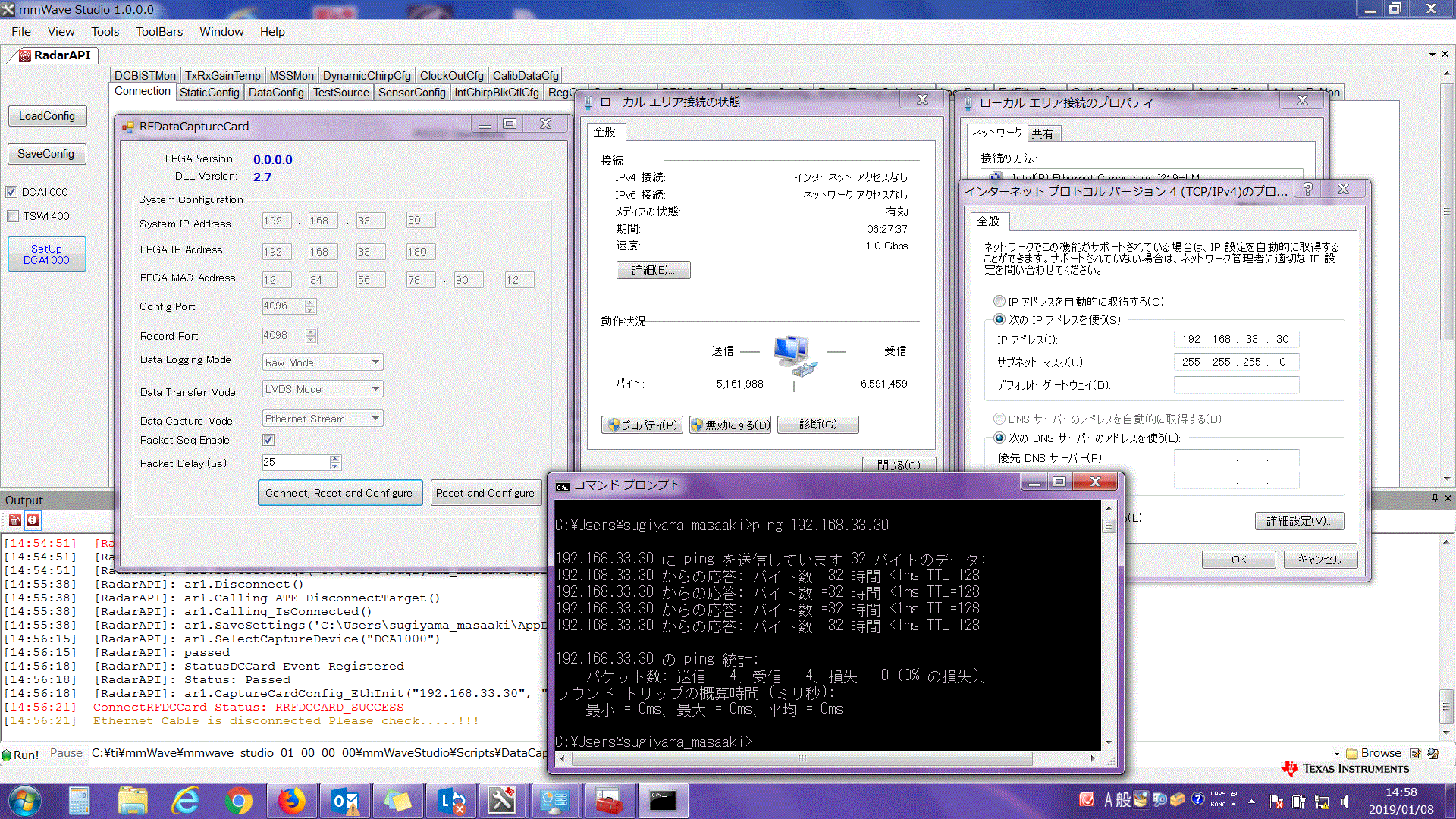

  • Hi Sugiyama-san,
    Can you please post a screenshot of mmWaveStudio after you ran the above sequence?
    This sequence looks correct, and you should be able to use the board after this point.
    Also, Radar Studio has an "Output" Window that I do not see in your earlier screenshots. You can activate it from the "View -> Output" menu.
    This window has a running log of all the events that occur when you run a script or run commands manually. Can you post that log here for both cases?
    Anand

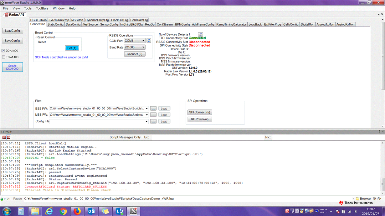

  • Dear Anand-san;
    Thank you for your support.
    I attaeched three logfiles.
    Please see these files.
    1.mmwave-studio_start.log : GUI startup log
    2.mmwave-studio_manual.log : log of manual
    3.mmave-studio_lua.log : log of using scripts
     Masaaki Sugiyama

    [13:24:14]  [RadarAPI]: ar1.SelectCaptureDevice("DCA1000")
    [13:24:14]  [RadarAPI]: passed
    [13:24:14]  SelectCaptureDevice Success
    [13:24:15]  [RadarAPI]: StatusDCCard Event Registered
    [13:24:15]  [RadarAPI]: Status: Passed
    [13:24:15]  [RadarAPI]: ar1.CaptureCardConfig_EthInit("192.168.33.30", "192.168.33.180", "12:34:56:78:90:12", 4096, 4098)
    [13:24:18]  Ethernet Cable is disconnected Please check.....!!!

    Can you confirm that you have attempted to configure the IP address for your ethernet interface to 192.168.33.30?
    Would it be possible to share a screenshot showing the "Network adapters" section of device manager on this computer?
    Anand
  • Dear Anand-san;
    I attached file.
    But, my PC is Japanese.
    And I confirmed "PING" command, that was OK.
     Masaaki Sugiyama
