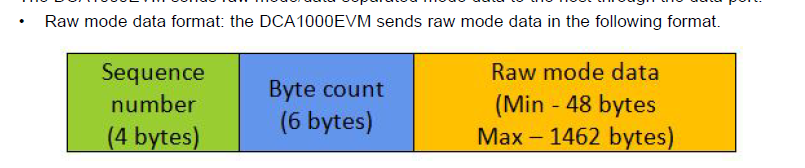

Hello, I am having some trouble reading in raw data via ethernet from the DCA1000EVM. According to the DCA1000 User Guide, the data format is as follows:
I have SW4 on the DCA1000 DIP switch set to Raw Data, so this is the type of packet I am receiving. The specific configuration of the radar device was for 4 receivers, complex 1x data, 256 ADC samples per chirp. After I received a packet, the length of every packet was 1466 bytes: 4 for the sequence number, 6 for the byte count, 1456 for the data. This means there are 1456/2=728 IQ samples and 728/2=364 ADC Samples in the packet. I know that each sample is LSB so I would reorder the following stream like so:
abfc9afc79fe61fc29fe590115fa7df933032c0517fa02fb41072708f5fc8fff (RAW)
fcbafc9afe79fc61fe290159fa15f97d0333052cfa17fb0207410827fc5fff8f (REORDER)
Where red is RX1, green is RX2, blue is RX3, and black is RX4. Next, I would take each I and Q sample individually, convert it to hex, and subtract 2^15 to convert out of 2's complement notation. I take the I and Q sample for each receiver and combine it into one complex sample by the following: I+1j*Q. Therefore, after capturing 3 packets (3 packets * 1456 bytes/packet = 4368 bytes > 4096 bytes needed for 256 complex samples for 4 receivers) a full chirp's worth of information is captured and ready for a 1D fft. I apply the fft across each receiver so that I am taking the fft of an array of size 256 four separate times. I take the absolute value of the fft and then plot it on a log scale.

  • Hello Samuel,
    Please find my reply below
    >>Here are my questions:
    >>1) Do I need to have the DCA1000 DIP SW3 set to AWR1642 or AWR1243 mode? I am using the AWR1642, but if I want a high ADC data rate out >> of my board, would using AWR1243 mode affect the parsing of the raw data capture?
    [TI] If you are using the 1642 device you need to set the switch to AWr1642 selection. Incase of AWR1243 mode the DCA1000 will assume there are 4 LVDS lanes which is not the case on 1642
    >>2) Does the ADC data pick up where it left off while transitioning between packets? For example, if the last data sample at the end of packet 1 is >>RX0 (I) would the first data sample at the beginning of packet 2 be RX0 (Q)?
    [TI] That is right , basically the large chunk of data is collected and then split into UDP packets.
    >>3) Do you notice anything wrong with my procedure of taking the 1D FFT?
    [TI] IN 1642 the complete chirp data of the one receiver chain (eg RX1) is sent out first then the RX[1] data , so on and so forth. So you will get 256 samples of I and Q data corresponding to RX1 followed by 256 samples of RX2 etc. Also for the 2's compliment conversion to signed number you need to substrate 2^16 (not 2^15)
    Vivek
