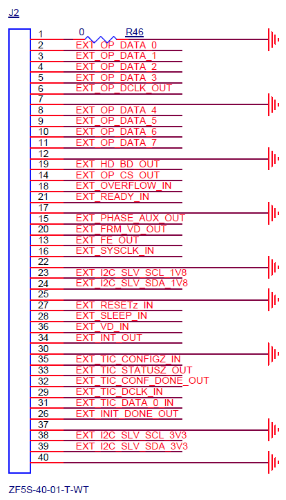

1. Can the slave mode be activated simply from the voxel  viewer?

3. According to the following figure, the pin number for VD_IN is 36, but that pin is not the 36th pin. What is the correct VD_IN pin?

    The pin numbers in this symbol are not in order. But the pin numbers are correct. Do you face difficulty in probing this pin to receive the signal?
