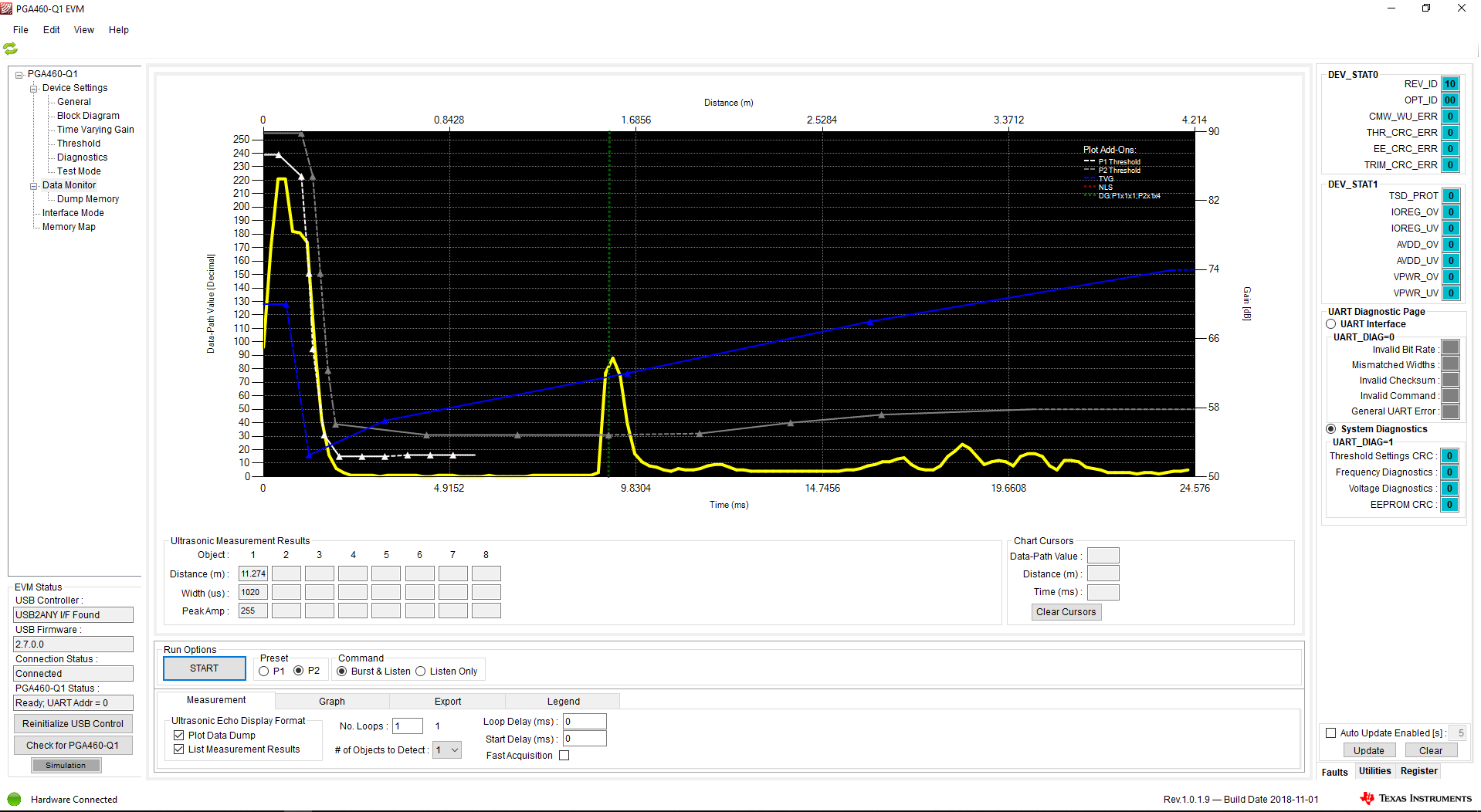

  • Akeem,
    I am using an external module with OWU communication connected to BOOSTXL-PGA460 demo (J6 connector). I'm finding it strange the distance value being informed, as you can see in the picture the excitation signal of the sensor and the echo received along with the Threshold levels should have a distance of approximately 30cm. In the field UMR is reported 11,239 meters.
  • Hi Jonathan,
    The PGA460 device installed on the BOOSTXL-PGA460's IO pin is completely decouple via software or hardware?
    If the echo data dump and threshold values read out to correctly reflect what you are displaying, there is no reason the UMR should not update.
    Be sure that you have checked the "UMR" checkbox in the Plot/Export tab. Also try unchecking the "EDD" checkbox to exclusively update the UMR table. Regardless of the interface mode, the UMR does not update when DATADUMP_EN=1. The GUI should automatically update the DATADUMP_EN bit between each EDD and UMR iteration, but you may have discovered an error case.

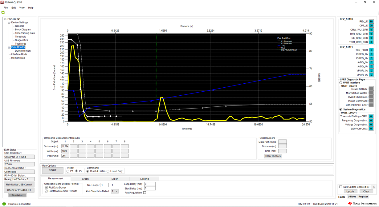

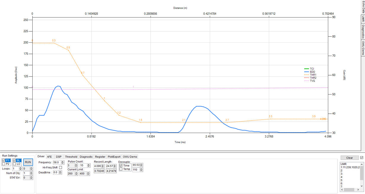

  • Hi Akeem,
    Yes it is decoupled via hardware (desoldering R15). I noticed that this problem happens both using the OWU interface and the UART. Here are 2 more examples of the situation where this occurred:
  • Hi Jonatan,
    A few more items to check/debug:
    1) Do you see the false positive when running a listen only command?
    2) Is the device set to Time Decouple mode at 65ms (max) to prevent the DECPL from activating internally?
    3) If you change the digital gain's LR starting threshold time to a different value, does the false positive peak also move?
