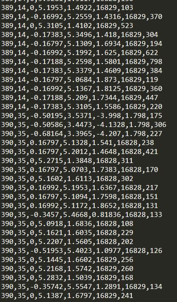

I currently run the demon in AWR1443 for Zone Occupancy Detection. The result in .csv file just like below
I am confused about the velocity in the sixth row, since the number is too high(16829 or 16828).
and I also think that the velocity should have a direction(towards the radar or not). Is something wrong here?

    Hello Li,
    That's unexpected - it should be doppler and signed in m/s. Are you using the precompiled binary provided with the lab to flash the device?

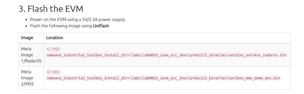

  • Hi Amanda,
          Thanks for reply.
          If you mean to flash the device like the step below using uniflash. Yes, I have done that.
