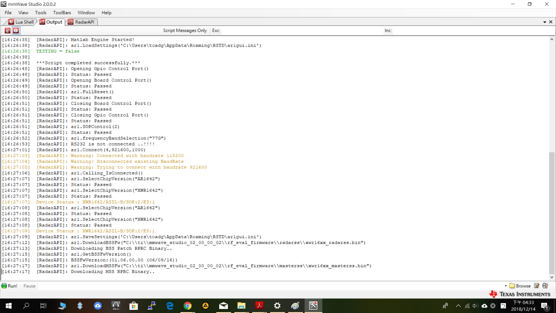

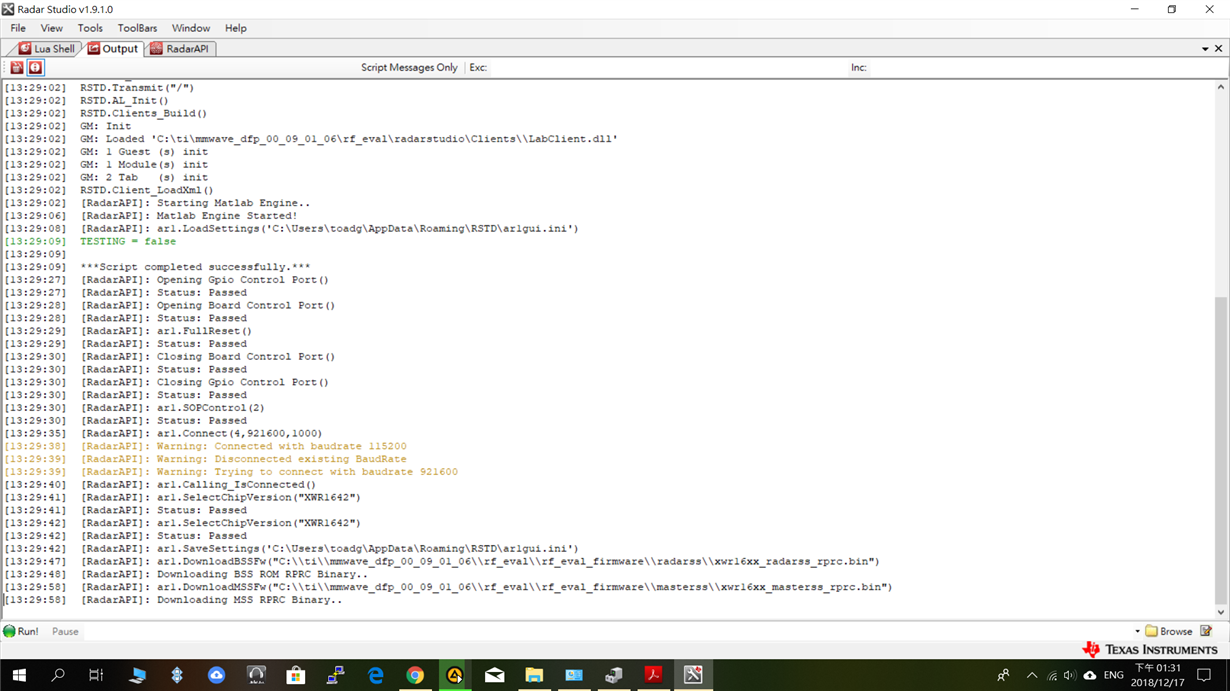

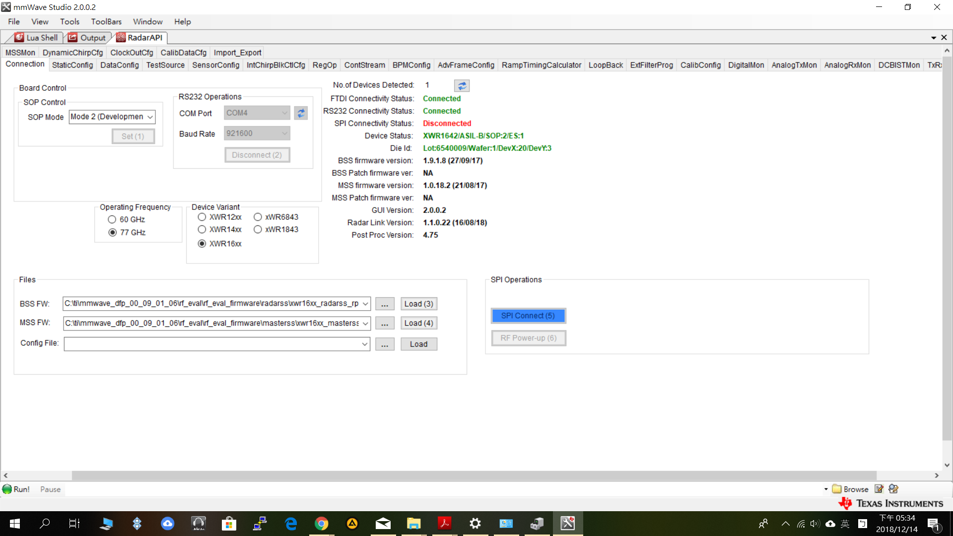

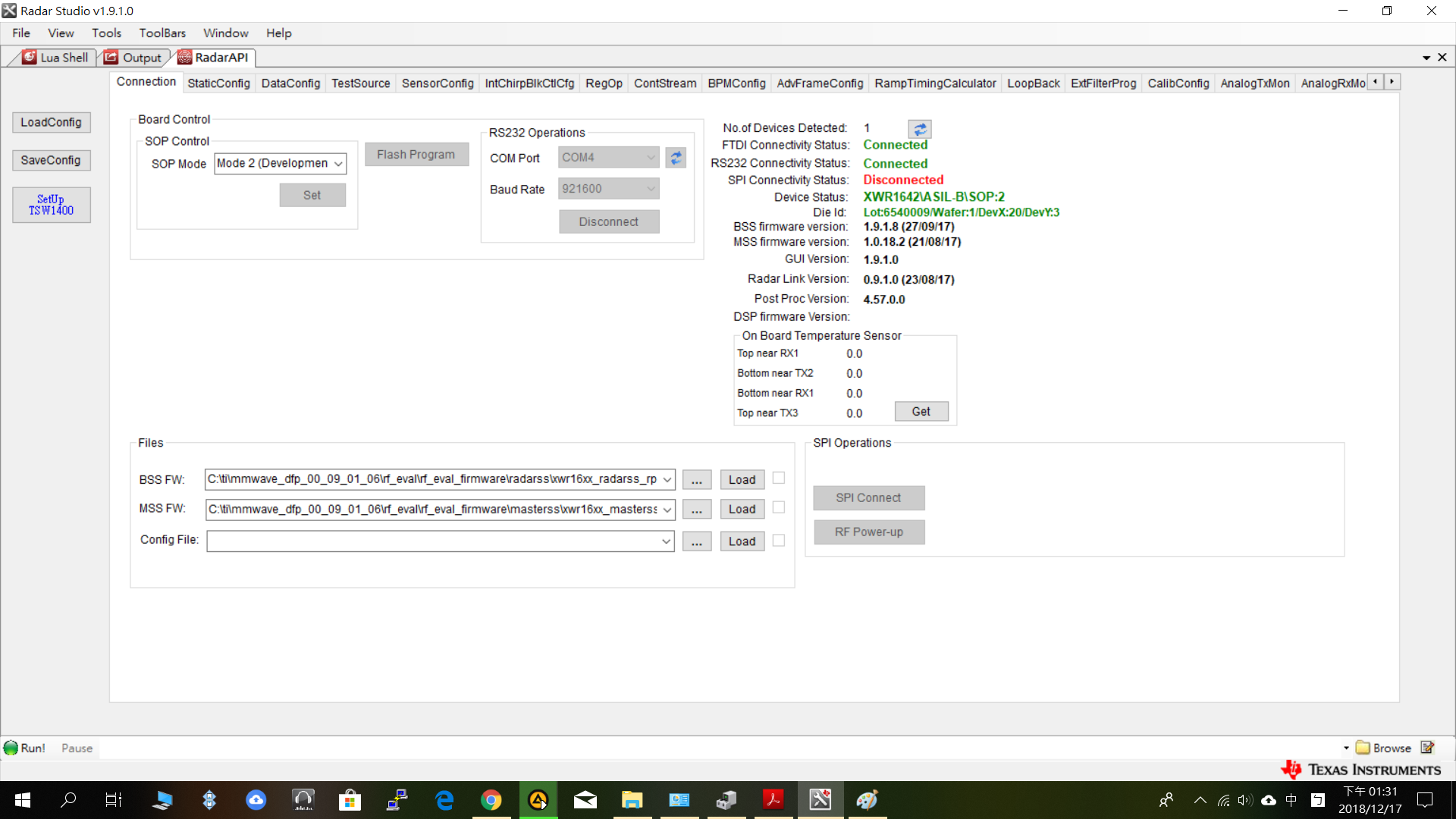

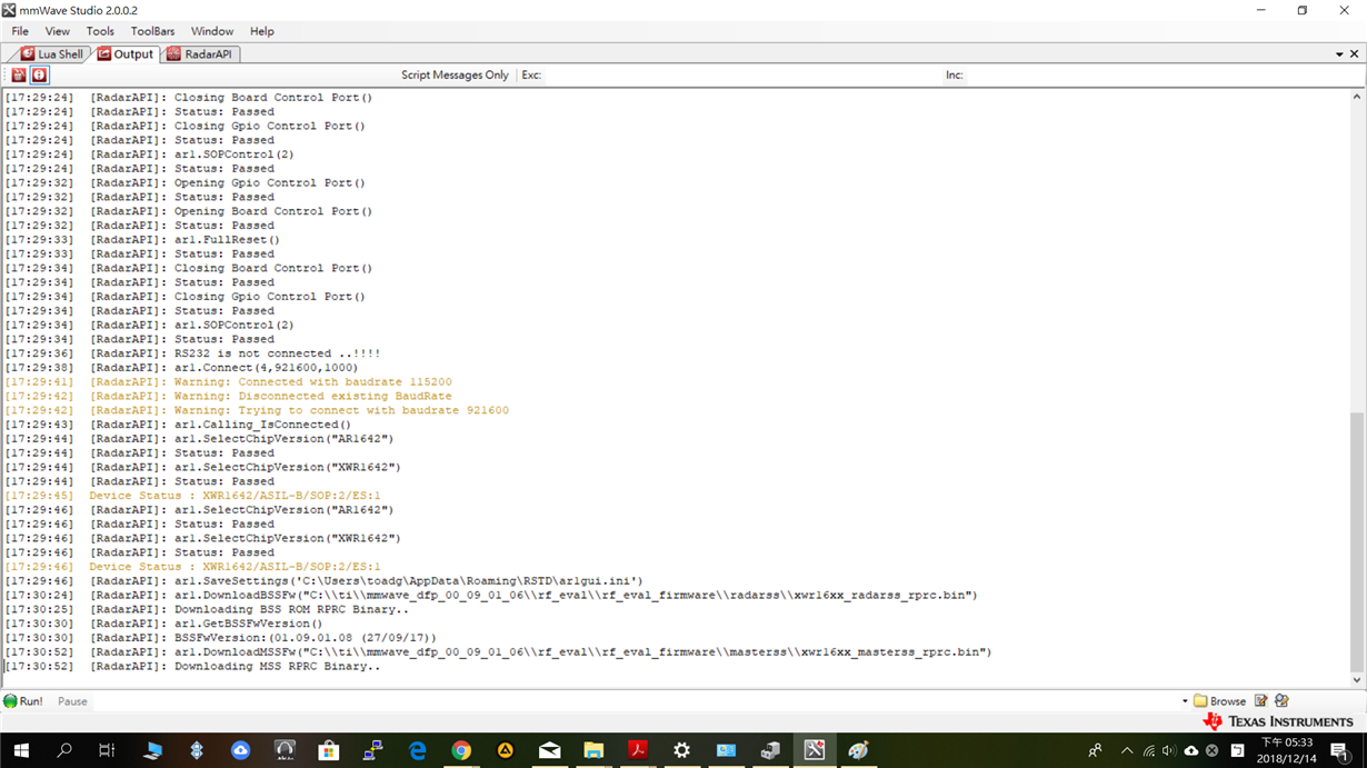

I used mmwave studio, the SPI can not connect.
How to solve this problem?

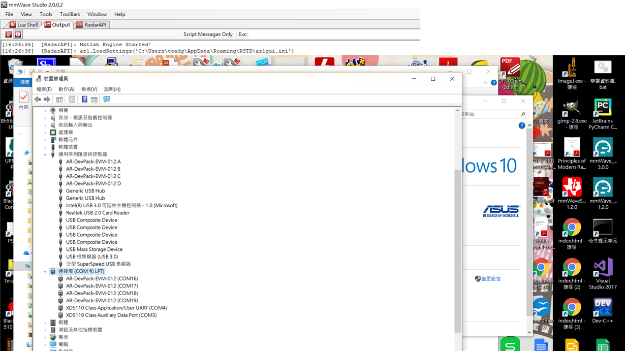

I checked the HW (AWR1642 Boost Board and mmwave-DevPack).
After I went to the local office of TI, and checked these. The mmwave-DevPack board has problem.
The other mmwave-DevPack board of TI is normally,.
