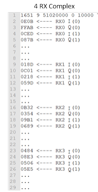

Q2:
i know the format of data (AWR1642) is non-interleaved,this picture is 1tx.4rx:
but if i use 2tx and 4rx,What is the format of the storage?
This is my understanding:
RX0-I(0)       (TX0)
RX0-Q(0)      (TX0)
RX0-I(0)       (TX1)
RX0-Q(0)      (TX1)
RX0-I(1)       (TX0)
RX0-Q(1)      (TX0)
RX0-I(1)       (TX1)
RX0-Q(1)      (TX1)
RX0-I(2)       (TX0)
RX0-Q(2)      (TX0)
RX0-I(2)       (TX1)
RX0-Q(2)      (TX1)
RX1-I(0)       (TX0)
RX1-Q(0)      (TX0)
RX1-I(0)       (TX1)
RX1-Q(0)      (TX1)
RX1-I(1)       (TX0)
RX1-Q(1)      (TX0)
RX1-I(1)       (TX1)
RX1-Q(1)      (TX1)
Is my understanding correct?

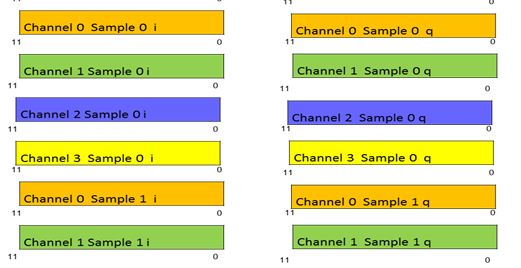

  • Hello Wei Liu,
    A1:  For TDM MOMO, you will need to configure 2 chirps that have the same profile. You seem to have configured the chirps right. Why do you think this is wrong?
    A2: Below is the snapshot for interleaved and non-interleaved data format
    non-interleaved
    Interleaved
    Let me know if this clears your doubt.

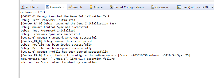

  • in ti/drivers/test/mem_capture:
    For Q1:
    I have tried this way to configure and perform data collection, but I have an error, as follows:
    and these are my code:
    static void MemCapture_initLinkChirpCfgParams (rlChirpCfg_t* ptrChirpCfg)
       /* Initialize the chirp configuration: */
       memset ((void *)ptrChirpCfg, 0, sizeof(rlChirpCfg_t));
       /* Populate the chirp configuration: */
       ptrChirpCfg->chirpStartIdx   = 0U;
       ptrChirpCfg->chirpEndIdx     = 0U;
       ptrChirpCfg->profileId       = 0U;
       ptrChirpCfg->startFreqVar   = (uint32_t)(0U * (1U << 26) / 3.6e9);
       ptrChirpCfg->freqSlopeVar   = (uint16_t)(0U * (1U << 26) / (3.6e6 * 900.0));
     ptrChirpCfg->idleTimeVar     = (uint32_t)(0U * 1000 / 10);
       ptrChirpCfg->adcStartTimeVar = (uint32_t)(0U * 1000 / 10);
    ptrChirpCfg->txEnable       = 1U;
       ptrChirpCfg->chirpStartIdx   = 1U;
       ptrChirpCfg->chirpEndIdx     = 1U;
       ptrChirpCfg->txEnable       = 2U;

    static void MemCapture_initMMWaveOpenParams (MMWave_OpenCfg* ptrOpenCfg)
       /* Initialize the open configuration: */
       memset ((void*)ptrOpenCfg, 0, sizeof(MMWave_OpenCfg));
       /* Populate the open configuration: */
       ptrOpenCfg->freqLimitLow                       = 760U;
       ptrOpenCfg->freqLimitHigh                       = 810U;
       ptrOpenCfg->chCfg.rxChannelEn                   = 0xFU;//Enable RX Channel 0,1,2,3
       ptrOpenCfg->chCfg.txChannelEn                   = 0x3U;//Enable TX Channel 0,1
       ptrOpenCfg->chCfg.cascading                     = 0U;
       ptrOpenCfg->lowPowerMode.lpAdcMode             = 1U;
       ptrOpenCfg->adcOutCfg.fmt.b2AdcBits             = 2U;//16bit
       ptrOpenCfg->adcOutCfg.fmt.b2AdcOutFmt           = 2U;//Complex with Image band
       ptrOpenCfg->disableFrameStartAsyncEvent         = false;
       ptrOpenCfg->disableFrameStopAsyncEvent         = false;
    So I want to know if I have to modify other parts of the code?
    For Q2:
    You didn't understand my problem. I have read the message about non-interleaved fomat from 'xWR1xxx ADC Raw Data Capture' .So i have known the message that you post me.(You send the message which is about tx1,rx1)
    Now i want to use ti/drivers/test/mem_capture in tx2,rx4 mode. I want to know if i get the data from L3 , what format is it stored in?
    In addition, I want to know if the tx1,rx4 mode is used in mem_capture, is it stored in the same format as the non-interlaced mode you mentioned?
