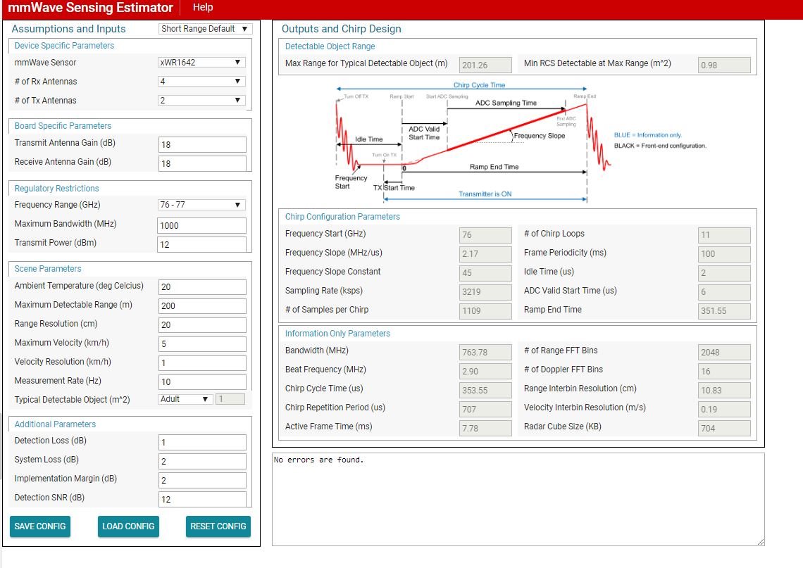

Hi, there is a customer needs that requires 200m people detection range, 5 degree angle resolution and 30 degree FOV is enough. Do you have any suggestion on the antenna re-design?
Thanks.

This would requires redesign of antennas, Higher distance would need higher antenna gain, In this case probably in the vicinity of 18-20 dBi .
There are other elements you may want to consider such as frame rate, RF Bandwidth, IF bandwidth, Range resolution, Velocity resolution, losses in the system etc. .
You may want to try mmWave system estimator from the below location.
https://dev.ti.com/gallery/view/1792614/mmWaveSensingEstimator/ver/1.3.0/

Regarding to the antenna gain, our engineer evaluated the antenna design and found that it is difficult to get 20dBi gain based on the MIMO antenna layout, do you have any suggestion on that?
