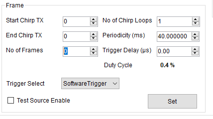

How to use continuous chirping for testing?
We want enable one TX only and use continuous chirping mode for testing.
e.g. Like test audio quality, playback(output) 1Khz sine wave to testing device, then testing device show test result.

If its a demo you can look in the configuration file.
Below is the configuration file for the high accuracy lab
dfeDataOutputMode 1
channelCfg 1 1 0
adcCfg 2 1
adcbufCfg 0 1 1 1
profileCfg 0 77 7 7 114.4 0 0 33.71 1 512 5000 0 0 48
chirpCfg 0 0 0 0 0 0 0 1
frameCfg 0 0 10 0 500 1 0
lowPower 0 1
guiMonitor 1 1 0 0 0 1
RangeLimitCfg 2 1 1.0 3.0
sensorStart
Here you can see in red, that "frameCfg 0 0 10 0 500 1 0" , this controls the number of frames, if you set it to zero then it infinetly repeats.
For details click here, and download the "Users Guide", go to "3. 4. Configuration (.cfg) File Format", located on page 13.
If you are using mmWave studio with DCA1000 you can do the same:
hope this helps.
