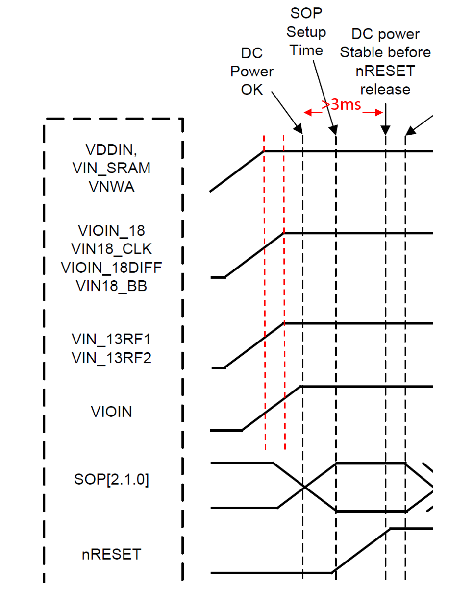

    I'm sorry but this isn't answering my question. I understand that some kind of timing sequence needs to be respected, but it's not at all clear from the image in the datasheet what that timing sequence is.
    In the hardware checklist I saw mention of the 3ms delay after the lines are stable before asserting the reset, so I'm following that.
    But I'm worried by the fact that the datasheet picture appears to show the VDDIN supply activating first, followed by the VIOIN_18 and VIN13RFx supplies at the same time, and finally the VIOIN (see photo below, where I drew in extra lines in red to make my question more clear:
    As shown in the snippet you attached, please make sure the lines activated in the same sequence and the steady state is reached in the same sequence shown. I hope this answers the question
    Charles O
  • But there are no specified minimum delays?
  • Yes. The time for the voltage rails to settle will vary from PMIC to PMIC so specifying the delay is not a feasible option
  • I find it strange that a certain power-up sequence is required, but no information (even ballpark) can be given on what the delays between the rails being applied should be.
    1ns? 1ms? 100ms?
    Even the IWR6843ISK doesn't seem to respect this sequence, with VDDIN, VIOIN_18 and VIN_RF all being applied at the same time, and only VIOIN being delayed by the load switch.
    I'm going to just use that same configuration on my design then, but it's a shame that I don't understand the actual requirement.
    We will make amendments and add more details to the datasheet as needed .
    However as indicated earlier there are factors including the PMIC used that can vary the timing of the various voltage rails.
