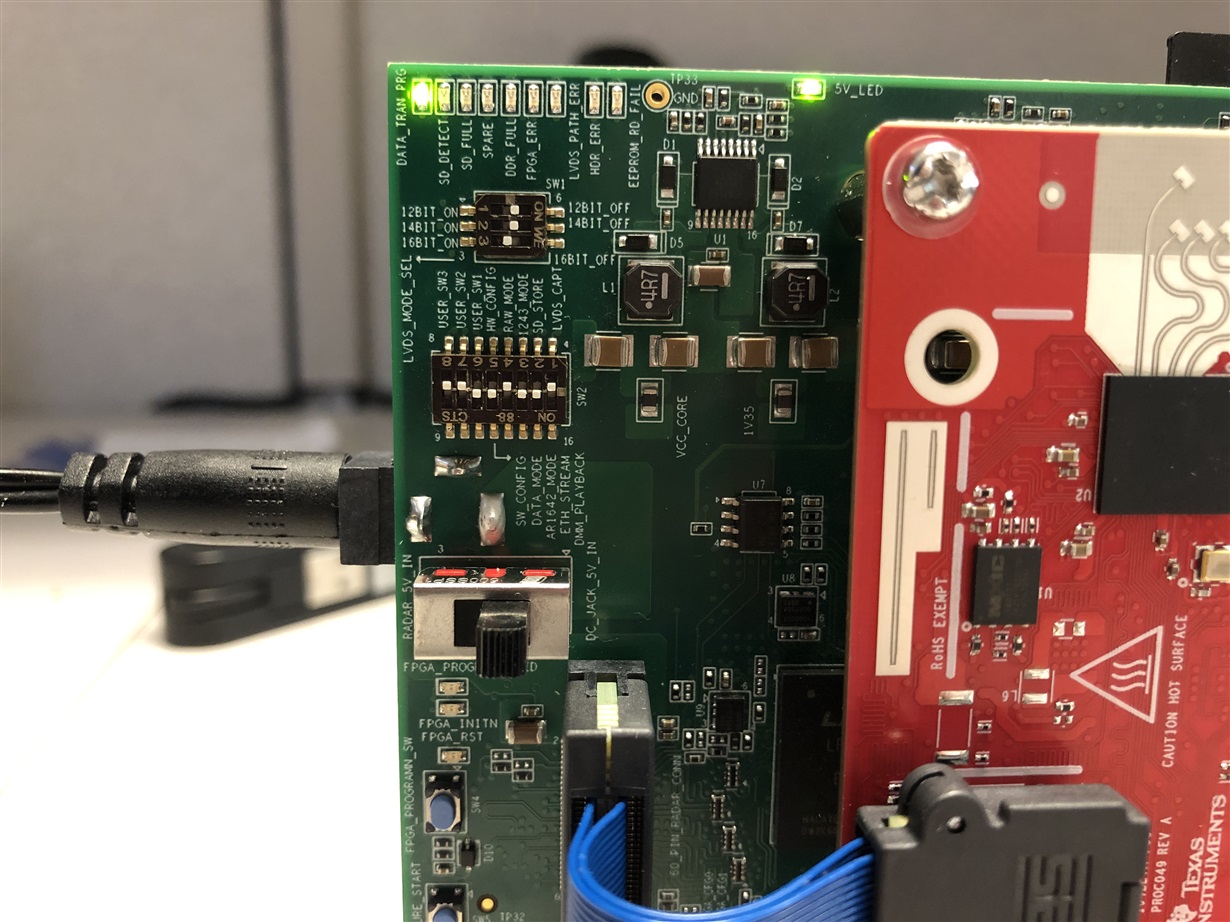

1) plug in AWR1642 and DCAEVM1000 to power (separate supplies)
2) start mmwave studio
3) reset button in RadarAPI window Reset control
4) Connect button in Radar API window for RS232 Operations1
5) Run DataCaptureDemo_xWR.lua

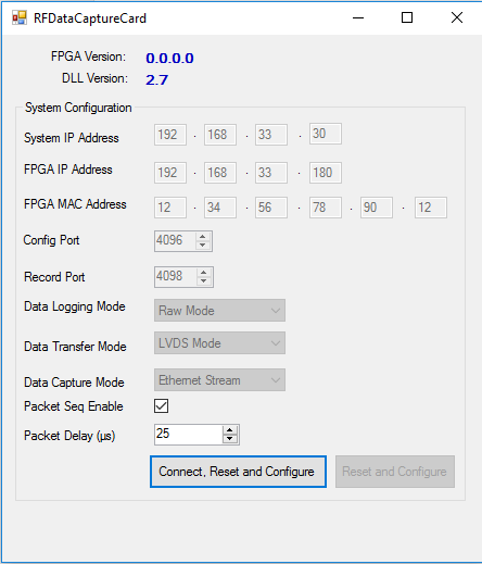

[16:14:03] [RadarAPI]: ar1.CaptureCardConfig_EthInit("192.168.33.30", "192.168.33.180", "12:34:56:78:90:12", 4096, 4098)
[16:14:03] [RadarAPI]: Status: Passed

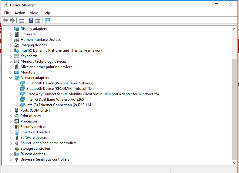

[16:14:05] Ethernet Cable is disconnected Please check.....!!!
[16:14:05] CaptureCardConfig_EthInit Success
[16:14:06] [RadarAPI]: ar1.ConfigureRFDCCardMode(1, 2, 1, 2, 3, 30)
[16:14:06] [RadarAPI]: Status: Passed
[16:14:06] CaptureCardConfig_Mode Success

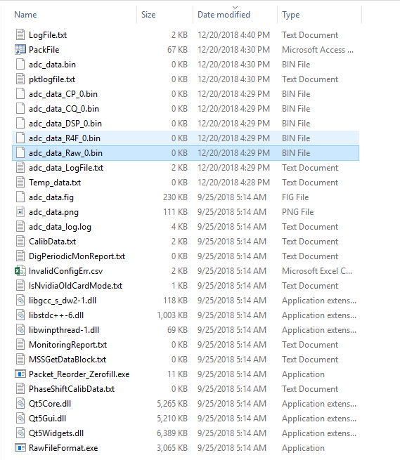

Wireshark shows data transfer from DCA1000EVM
The datafile on my computer is 0kb in size so the data is not being saved but it does appear to be transmitted by the EVM.  I do not see any issues with firewalls as mmwave studio has inbound open.  Maybe there is another program that mmwave studio uses to capture the data that needs to have an inbound rule?  Although I should not have the Ethernet cable disconnected message in my output log which looks to be a bug in mmwave studio as I can see the ethernet packets in wireshark.

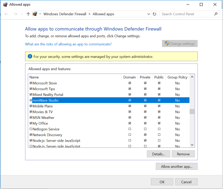

Again, I have searched for this issue and tried all the steps outline so yes I followed the quick start guide, I have checked dip switches, I have re flashed the FPGA, checked the firewalls, use wireshrak
I am using a win 10 machine.
