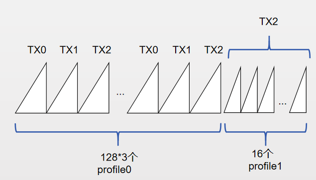

I  come across a problem when I make the waveform configuration using mmWaveStudio. We use DCA1000&awr1243 to transmit and receive the wave.How to transmit the waveform in  the figure below?

    First block of waveform, it is easy to create, where you need to select chirpConfig with selection of Tx0/1/2 with profile0
    chirpConfig0 : profileID=0, startChirp = 0, endChirp=0, TxEnable=Tx0.
    chirpConfig1 : profileID=0, startChirp = 1, endChirp=1, TxEnable=Tx1.
    chirpConfig2 : profileID=0, startChirp = 2, endChirp=2, TxEnable=Tx2.
    and at the Frame configuration select Start-Chirp=0, end-Chirp=2, noOfLoop=128.
    Now coming to your configuration, as you have last 16 chirp connected to single profile+Tx2, so you need to configure all 400 chirps (128*3+16) due to non-regularity
    chirpConfig3 : profileID=0, startChirp = 3, endChirp=3, TxEnable=Tx0.
    chirpConfig4 : profileID=0, startChirp = 4, endChirp=4, TxEnable=Tx1.
    chirpConfig5 : profileID=0, startChirp = 5, endChirp=5, TxEnable=Tx2.
    chirpConfig381: profileID=0, startChirp = 381, endChirp=381, TxEnable=Tx0.
    chirpConfig382: profileID=0, startChirp = 382, endChirp=382, TxEnable=Tx1.
    chirpConfig383 : profileID=0, startChirp = 383, endChirp=383, TxEnable=Tx2.
    chirpConfig384 : profileID=1, startChirp = 384, endChirp=399, TxEnable=Tx2. [For last 16 chirps]
    Frame configuration select Start-Chirp=0, end-Chirp=399, noOfLoop=1.

    You can use the advanced frame configuration API (please refer to AWR_ADVANCED_FRAME_CONF_SB in the Interface Control Document) to configure two subframes. The first subframe will contain 3 chirps with profile 0 starting at chirp 0, looped 128 times. The second subframe will contain 1 chirp (say chirp 4) with profile 1, looped 16 times.
    Please note that a minimum inter-subframe time of 100 us will be needed.
