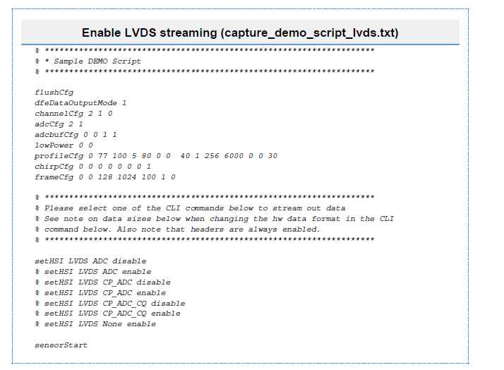

    previously I used older board (IWR 1443 ES2 ) and sdk 1.1 which has "capture demo" and I was able to flash "capture demo" on the board  and utilize it  to capture raw adc data.
    Now I have newer board(IWR1443 ES3) which is compatible with sdk 2.1
    My problem is that there is no "capture demo"  in sdk 2.1 so which file should I flash instead of that to be able to capture raw adc data .
    Probably there sould be alternative file to enable us capturing raw adc data

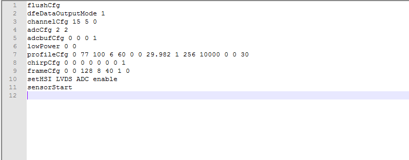

    "mmwave studio" is working correctly without any doubt. But for my application I need to process the raw adc data in real time . in mmwave studio  first I should record data for certain number of frames and chirps , ... then I have data and I can process them . But for my real time application I can't use it because i need to process data while I'm collecting data . So I should write my own script to collect data and process them
    according to page 18 of mmwave_sdk_user_guide(product releas 1.1) which is attached at the end I was able to send the below commands (I used IWR1443 ES2 and flashed "capture demo" and DCA1000) through the serial port  and collect data and process them using my own python script. My problem is that how can I do the same procedure with new device (IWR1443 ES3 )

    Since you already have a DCA1000 the best method would be to intercept the ethernet ADC packets with your python script and then you can do a continuous pseudo real time post processing.
