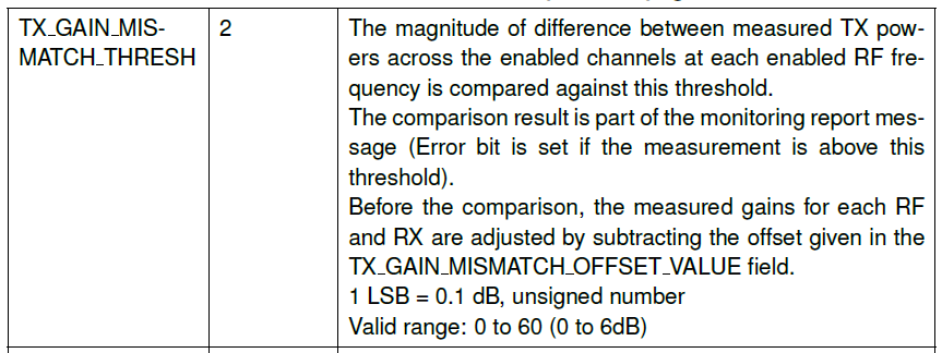

There're a lot of threshold for RF monitoring like:
1. AWR MONITOR RX GAIN PHASE CONF SB
RX GAIN ABS ERROR THRESH
RX GAIN MISMATCH THRESH
RX GAIN FLATNESS ERROR THRESH
RX PHASE MISMATCH THRESH
RX GAIN MISMATCH OFFSET VALUE
RX PHASE MISMATCH OFFSET VALUE
2. AWR MONITOR RX NOISE FIGURE CONF SB
RF FREQ BITMASK
RX NOISE FIGURE THRESHOLD
3. AWR MONITOR TX0 POWER CONF SB
AWR MONITOR TX1 POWER CONF SB
RF FREQ BITMASK
TX POWER ABSOLUTE ERROR THRESH
TX POWER FLATNESS ERROR THRESH
4. AWR MONITOR TX0 BALLBREAK CONF SB
AWR MONITOR TX1 BALLBREAK CONF SB
TX REFL COEFF THRESH
When entering mass production, these threshold should be decided.
Could you provide a document to describe how to determinate those thresholds?
