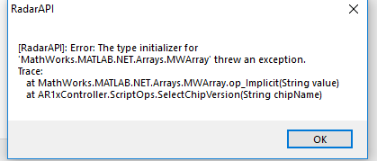

I tried to connect an AWR1443Boost to a DCA1000 EVM and using mmWaveStudio
to get data. but after connecting to serial port I get an error that seems comes from MATLAB.
The output is like bellow:
[17:07:49] [RadarAPI]: ar1.Connect(19,115200,1000)
[17:07:50] [RadarAPI]: ar1.Calling_IsConnected()
[17:07:55] [RadarAPI]: Error: The type initializer for 'MathWorks.MATLAB.NET.Arrays.MWArray' threw an exception.
[17:07:55] Trace:
[17:07:55] at MathWorks.MATLAB.NET.Arrays.MWArray.op_Implicit(String value)
[17:07:55] at AR1xController.ScriptOps.SelectChipVersion(String chipName)
[17:07:55] [RadarAPI]: RS232 is not connected ..!!!!
[17:07:55] [RadarAPI]: ar1.frequencyBandSelection("77G")
[17:07:55] [RadarAPI]: ar1.SelectChipVersion("XWR1443")
[17:07:55] [RadarAPI]: Status: Failed
[17:07:55] Device Status : XWR1443/QM/SOP:2/ES:3
[17:07:56] [RadarAPI]: Error: The type initializer for 'MathWorks.MATLAB.NET.Arrays.MWArray' threw an exception.
[17:07:56] Trace:
[17:07:56] at MathWorks.MATLAB.NET.Arrays.MWArray.op_Implicit(String value)
[17:07:56] at AR1xController.ScriptOps.SelectChipVersion(String chipName)
[17:07:56] [RadarAPI]: ar1.SelectChipVersion("XWR1443")
[17:07:56] [RadarAPI]: Status: Failed
[17:07:56] Device Status : XWR1443/QM/SOP:2/ES:3
[17:07:56] [RadarAPI]: ar1.SaveSettings('C:\Users\mostafak\AppData\Roaming\RSTD\ar1gui.ini')

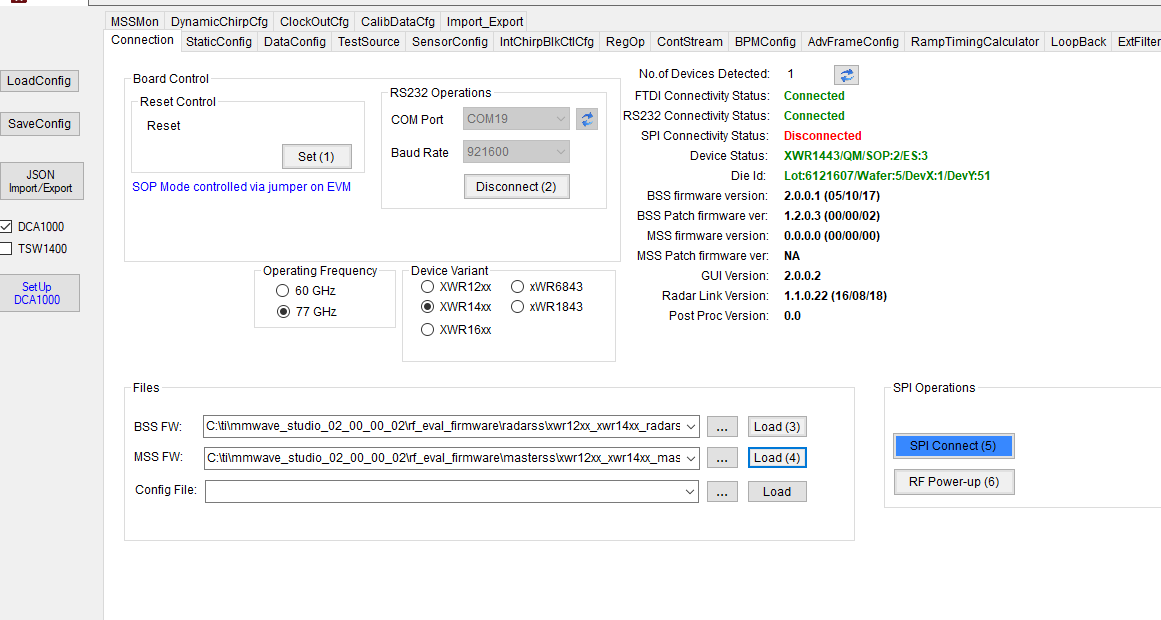

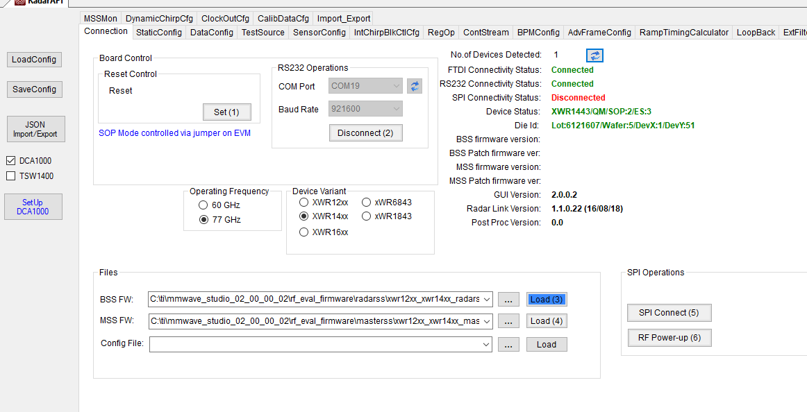

  • Hi Jitendra,
    As you can find from following images I have connection to RS232.
    Also I could load BSS, but I am suspected about MATLAB Run time.
    I have installed version 2018 b from MATHWORK, but couldn't find the link of it
    in the mmwave-studio user guide. Could you please send its link to me.
    FYI I have MATLAB 2018a on my computer installed.
    Mostafa
