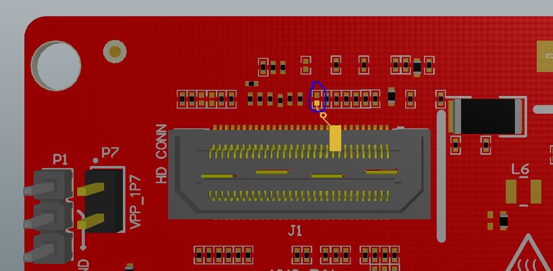

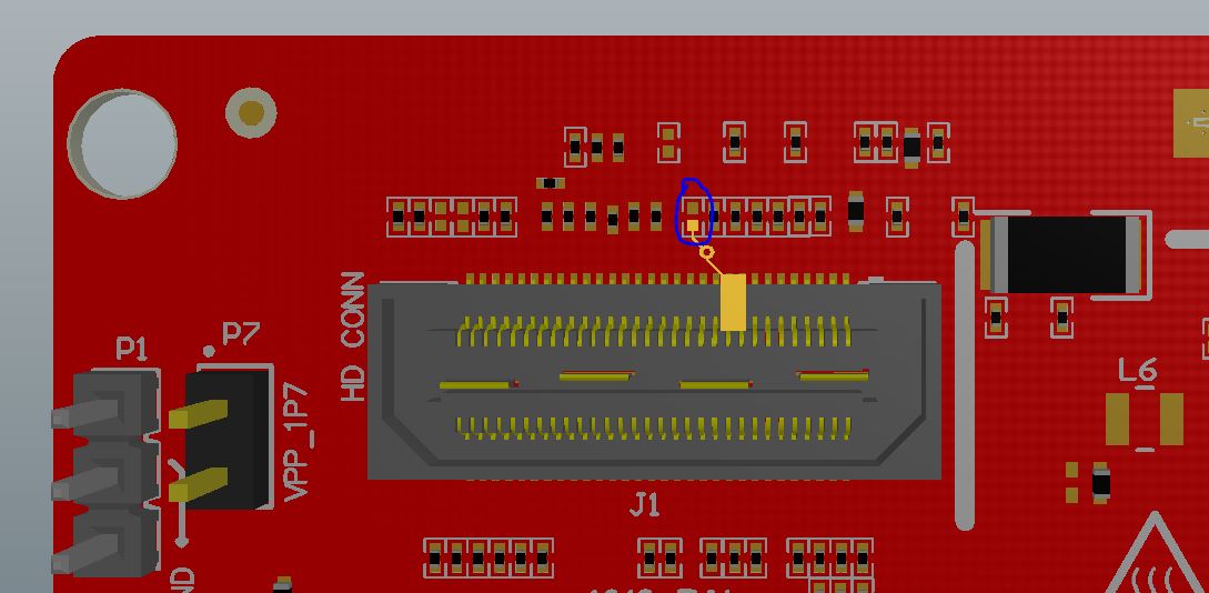

  • Thanks Jitendra. I have placed R135 and now I am getting UART signal at J5-Pin13 (BSS_Logger) in my scope but I still I am not getting signal at J5-PIN9 (MSS_Logger). I have two question
    1. Is BSS_Logger signal is same as MSS_Logger?
    2. Where can I find R26 on the board? I tried but could not find. I think that is neccessary to get signal at Pin13.
  •  Hello Laxmi,
    The BSS_logger is different. The pin Jiten was referring to was MSS_Logger.
    The R26 is location is marked in the below image (circled in blue). Its near the 60pin connector of the EVM.
    Vivek
