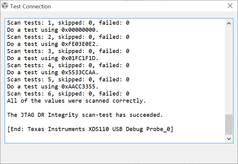

2. I tested JTAG connection using CCS V8 and I don't find any errors.

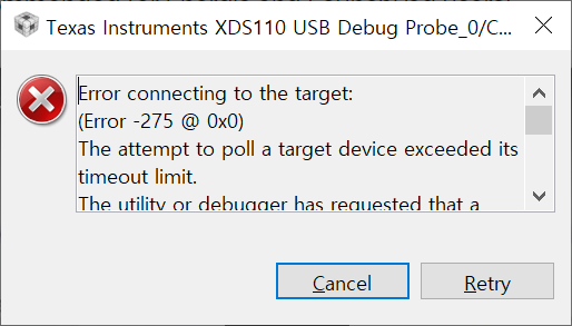

3. I trying to debugging but I can't, because it cause error

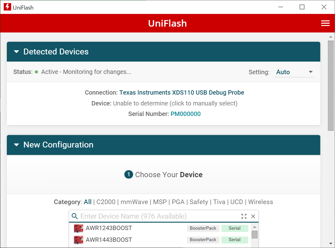

4. And I trying use UniFlash

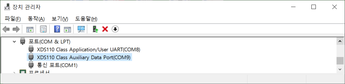

5. , But it cause can't connect error - But Windows Device Manager show me the COM8 port and CCS V8 JTAG test is passed.

1. SOP Mode: Set SOP mode 5 and Power off -> Push to hold reset SW -> Turn on the Power -> Release reset SW -> Still I see COM8 in Device Manager
2. Run Uni Flash -> Change COM Port to COM8 and choose IWR1642.bin image -> Load Image file
3. result -> Fail (Not able to connect serial port)

3. View -> Target Configuration ->Select IWR1642 -> Save -> Test Connection -> No error -> It's Ok (You can see attached image)
I trying to do debugging under CCS V8.3 ...
Image loading fail, Error connecting to the target

  • Dear Akash,
    A first thank you for your reply and Happy new year!
    Last week, I review all my schematic, PCB Gerber and PCB.
    And after I found some my mistake.
    VCLK and VBGAP is short inside of PCB.
    So, I correct these mistake and re-manufacturing of PCB now.
    Thank you
