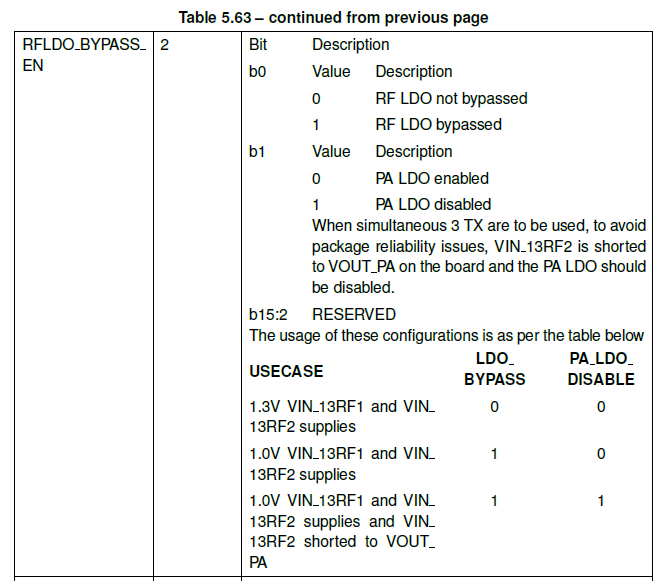

The mmWave Studio User's Guide, page 24, says the RF LDO Bypass Enable and PA LDO I/P Disable check boxes should not be checked, whereas the AWR1243 ICD, version 0.98, page 133,
says: "VIN 13RF2 is shorted to VOUT PA on the board and the PA LDO should be disabled"
Question 1:
What are the proper RF LDO Bypass Enable and PA LDO I/P Disable settings in the
StaticConfig tab in mmWave Studio 2.0.0.2 for AWR1243BOOST ES3.0?

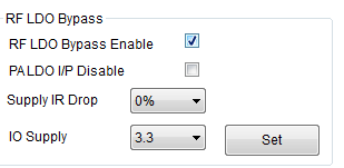

  • Hi mmUser,
    The AWR1243BOOST Rev B does not by itself support simultaneous 3 TX operation.
    Simultaneous 3 TX operation is only supported in the AWR1243P - an EVM for this part is not currently available, but it is a drop-in replacement to the AWR1243 ES3.0 part on the AWR1243BOOST Rev B EVM.
    For proper operation of the Rev B board, you need to select the "RF LDO Bypass Enable" option as in the following screenshot.

    Regarding the LDO settings, your suggestion doesn't seem to match the ICD, page 133. For the Rev B AWR1243BOOST, the schematics show that VIN_13RF1, VIN_13RF2, and VOUT_PA are all connected to the PMIC 1.0 V output. That matches the third USECASE in Table 5.63 suggesting that both LDO boxes should be checked. Please let me know if I'm interpreting that incorrectly.

  • Hi mmUser,
    You're correct - The PA LDO I/P disable also has to be selected for the Rev B boards.
