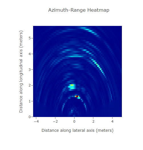

Additionally I noted this haloing effect when viewing a heatmap, and wondered if this is caused by a lack of angular resolution in the chip we have? (there is some rusting)

    Please refer to these two threads regarding parsing of the OOB demo UART stream:
    e2e.ti.com/.../758231
    e2e.ti.com/.../752834
    Range, azimuth, elevation is not radar cube but rather the data set that forms a 3D point cloud which is extracted from radar cube.
    For more information regarding radar cube and data processing please refer to the videos in the mmWave training series.
    training.ti.com/mmwave-training-series
    You can either implement your own processing algorithms on the device or by using a DCA1000 to capture raw data. The DCA1000 is advisable to give you more flexibility and ease in testing new algorithms.
