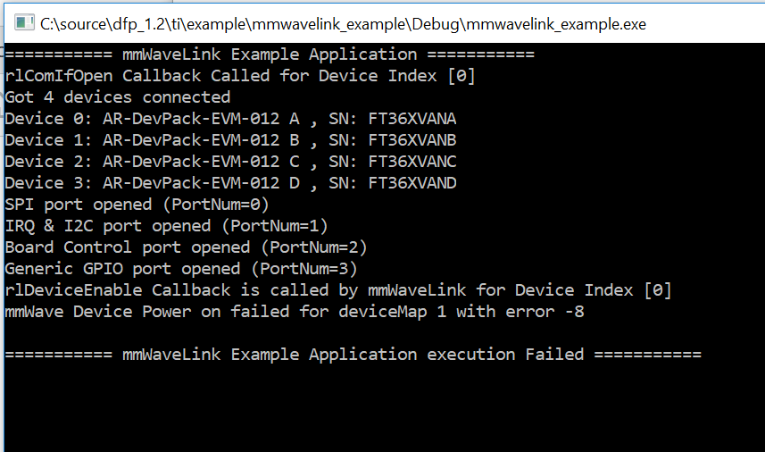

I am having difficulty getting mmwavelink_example.c to work with a RevB AWR1243BOOST + DCA1000EVM
mmwavelink_example.c is from mmwave_dfp_01_02_00_01\ti\example\mmwavelink_example

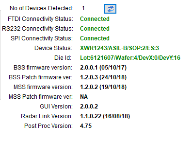

The same AWR1243BOOST and mmwavelink_example code work fine with the AWR1243BOOST+DevPack assembly, suggesting that the DCA1000EVM is the problem.
By stepping through mmwavelink_example with the VS debugger, it looks like rlDevicePowerOn() never receives an async event response.
Here is the listing from the command prompt:
The trace.txt file from the mmwavelink_example directory is empty except for the startup text:
[15:21:29:558][VER]mmWaveLink Studio Version: 1.1.0.0.28.3.18
How can I get mmwavelink_example to work with my AWR1243BOOST + DCA1000EVM?
