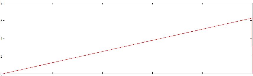

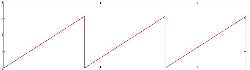

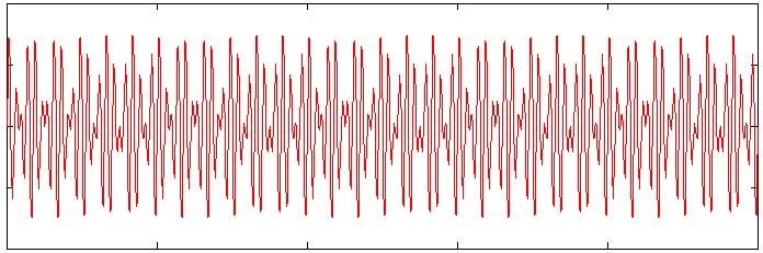

  • Clancy,
    Thank you for the quick and detailed response.
    Regarding the under-modulation question, the below graphs shows angle variation & Sin/Cos reading for low and high speed with the same excitation frequency.
    • For Low Speed : (angle variation)
    • Cosine Reading
    • For High Speed (Angle Variation)
    • Cosine reading
    Remark : these graphs were plotted using the same time scale.
    Thank you in advance
  • Followup question is in the comment below
  • This is for a multi-pole resolver correct? You should see that the angle output is correct as long as you stay within the datasheet specified speed (72,000 electrical RPM for 12 bit mode). It may be difficult to see on an oscilloscope, but if the signals are demodulated, they will revert to typical sin/cos signals.
