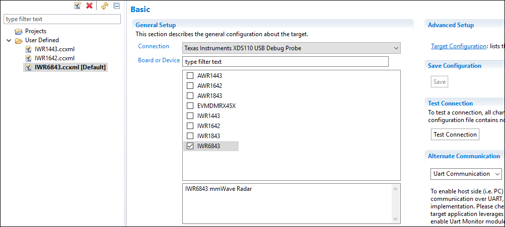

    While you're getting the above error in context of the Area scanner lab, it is not related to the Area scanner lab as you've not yet loaded the lab binary up to this point. As Vaibhav indicated, the error message you've shared indicates a general emulator connection problem. You can  also verify this by running the "Test Connection" feature in the CCS Target configuration. (Double click on the CCS Target configuration->Select Basic Tab-> Press Test Connection as shown below). Could you please run this test and share the output?
    -Nitin

    2. When you connect the XDS110 USB port to your PC, do you see the two COM ports enumerated in Windows Device XDS110 Class Application/User UART and XDS110 Class Auxiliary Data ports?
    3. Are you using the same CCS target configuration which you had working earlier or did you make a new one? In case you made a new CCS target config, could you please check that you have the Texas Instruments XDS110 USB Debug Probe selected in the Connection drop down as shown in the image above?
    -Nitin
