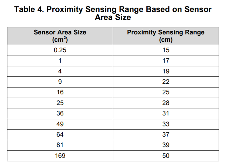

This is the sample video  from TI.  Still thinking how to determine its sensing range.
It says that the sensing range is depends on the sensor area size. FDC1004EVM has 1.3cm x 1.3cm sensor area size,
the sensing range maybe over than 15 cm. Changing the parameters might have some changes of the capacitance and sensing range as well.
It says that configuring a measurement involves setting the input  channels and the type of measurement ( either single ended  or differential)
My question is  what to set in the parameter of GUI if the FDC1004 interface to single ended capacitive sensor?
How about this FDC1004EVM? It is using differential  measurement.
