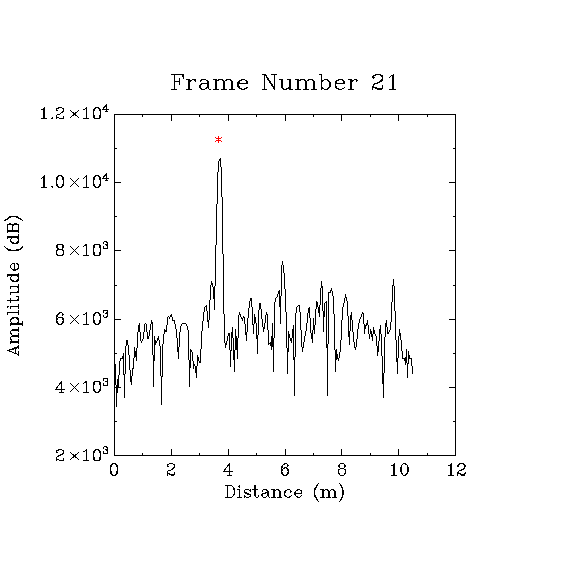

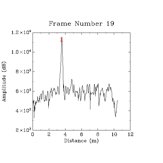

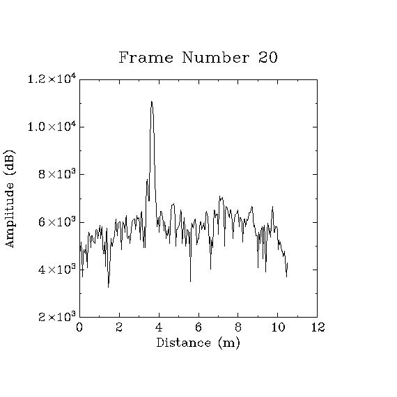

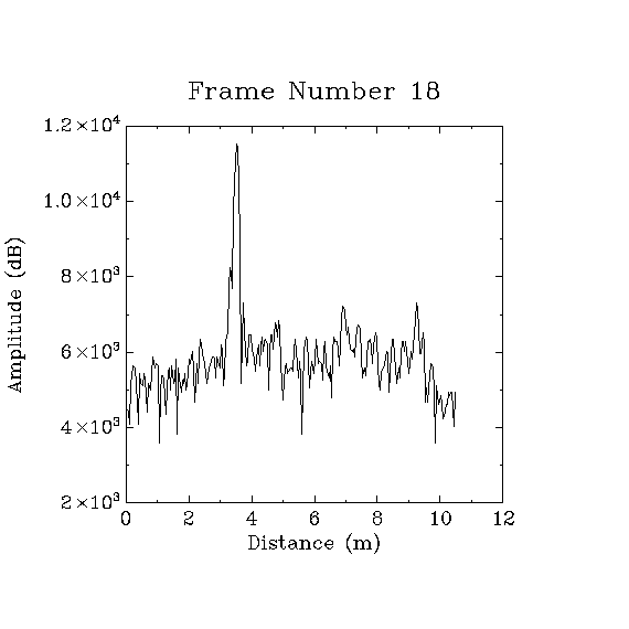

2.  Attached are some images where rangeDopplerLogMagMatrix (dopIdx=0) data is plotted along with the peakVal and rangeIdx data from the objOut structure.  Even though the downrange profile appears to have a single peak, several detected objects appear for the same single (?) peak and their peak values can be sufficiently different from the down range profile values.  I have reviewed the documentation in the doxygen directory and I am still fuzzy.  Can you please provide additional guidance on why the multiple peaks and peak values in the objOut structure appear to be inconsistent from the  rangeDopplerLogMagMatrix data?  In some cases, a frame may have no detected objects but clearly, there should be.  If I lower the threshold value, more detected objects are found (as expected) and their peak values have a greater variation in peak value.

    2. Even though the downrange profile appears to have a single peak, several detected objects appear for the same single (?) peak and their peak values can be sufficiently different from the down range profile values
    [NS]: You haven't provided your scene information. But there can be multiple objects with the same range bin because of
    a) Multi-object beam-forming is enabled which outputs the second highest peak in the same range bin if it's at a different azimuth angle and
    b) If the objects enough difference in velocity to be separated by the configured Doppler resolution.
    [NS]: Please run the demo with the mmWaveDemoVisualizer and then see if you see the above issues. You can save the UART data coming over the COM port and analyze it as well.
    I guess what I am looking for is a single peak value and corresponding velocity for each peak in a rangeDopplerLogMagMatrix profile.
    The values in the Range Doppler Log Matrix may not correspond one to one to the detected object list as more processing which includes CFAR, PeakGrouping and Angle of Arrival calculation is performed on those before the final detected object list is formed.

    2. I am confused while one frame my have detected object while the previous frame or the following one does not.
    [NS]: Whether an object/peak is marked as a detected object depends upon whether it met the configured Range and Doppler CFAR thresholds. Please look at this thread on an overview of the CFAR process. Please try reducing the Range and Doppler thresholds and see if you get the object detected more consistently across frames. Another possibility could be that you are exceeding the maximum velocity configured for the chirp in which case the computed Doppler value will wrap around.
