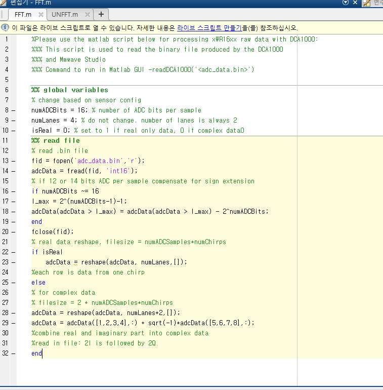

I used IWR1443BOOST+DCA1000
The above two figures are the data obtained from the adc_data.bin file using 1Rx as the mmWave Studio program, obtained by coding the MATLAB
I want to get the FFT from the above data values
