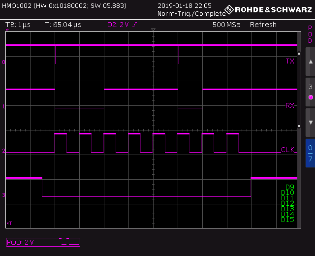

    You can refer to the PGA460 Energia Library and Code Example for an example on how SPI is implemented and used on the MSP430 MCU. Here is an example screen capture showing SPI in action during a Ultrasonic Measurement Result read command (command 5):
  • Hi Akeem
    I have setup the SPI so it matches the TX on your example screen, but RX answer is still 0x00, 0x00, Ox00.

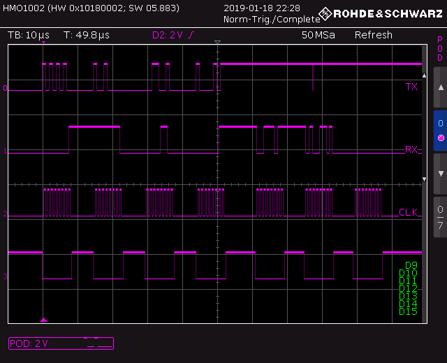

    Testing my application only in SPI-mode 0 I see a receive signal different from 0x00, 0x00, 0x00.
    However the data I get is somewhat confusing. TX is based on rising edge as SPI 0 indicates, RX is unclear on rising edges but 0xDC on falling edges.
    Last received byte is 0x00 with is not the checksum of the received data.
    Is 0x55 in sync mode realy required?
    Any explanations ?
    BR
    Oliver
    TX 0x55 on rising edge
    RX 0xDC on falling edge, unclear on rising edge
    full sequence TX 0x55,0x9,0x4x,0xA1   RX 0xDC on falling edge
