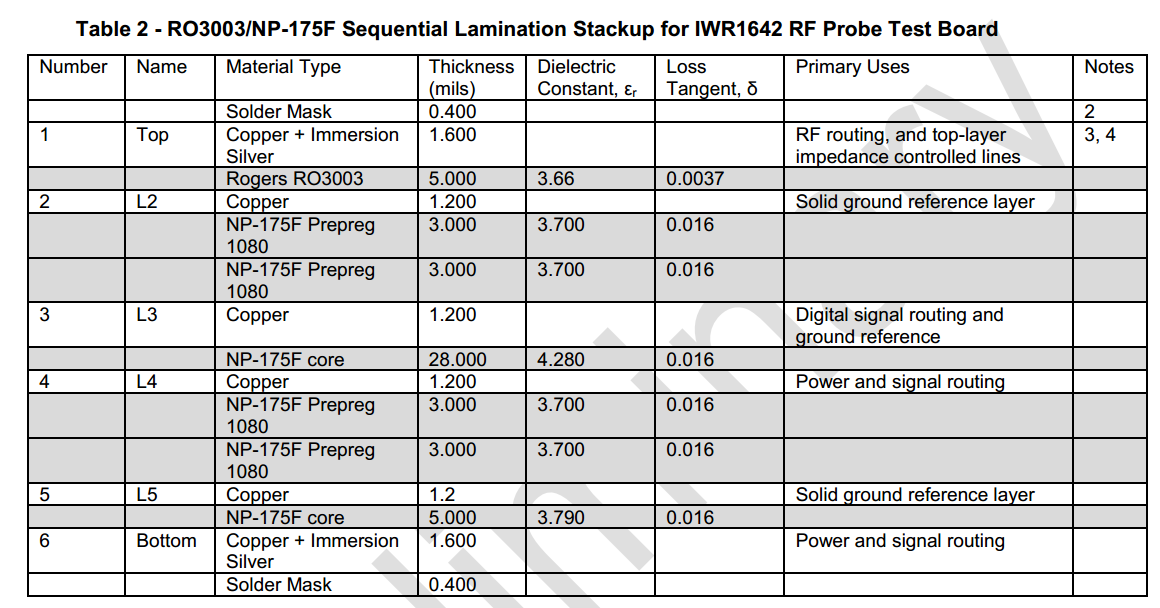

  I saw the iwr1642 RF probe test bord using the stackup below.
    I have one question about the RO3003's dielectric constant ,here , the file use the dielectric constant 3.66, this is equal to the dielectric constant of RO4835 ,is this dielectric right?
