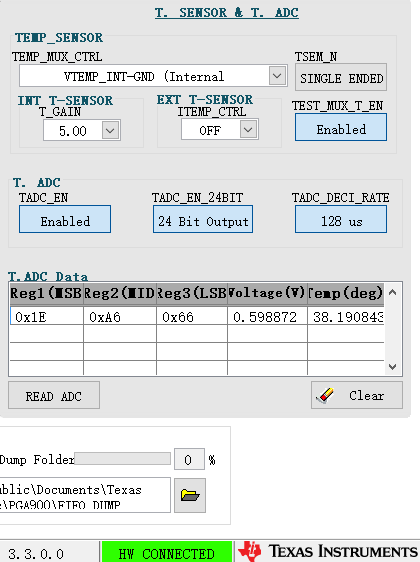

My GUI VER IS 3.3.0.0, is the formula above incorrect ?
(0x1EA04C-1710821)/6632=44
The formula from the datasheet is correct, so the one you have shown (which matches the datasheet) should be correct.
While the typical error for the internal temperature sensor of the PGA900 is listed as +/-6C, the offset can be quite high sometimes (10-15C is not out of the question). This is why we recommend calibrating the internal temperature sensor if it is being used for absolute temperature measurement.
If it is being used as a temperature reference for temperature and linearity compensation of pressure data, then only the relative values matter and this is not necessary.
