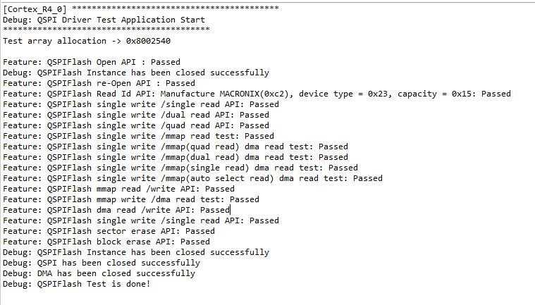

I took the test code and tried to execute it as a cli command.  Here is my code.  It does not return from the QSPIFlash_open.  What is wrong.  Is there a compiler option I need to set?  I followed the instructions from SWRA583.

    1. Have you been able to program the EVM using uniflash and running the OOB demo? need to confirm the board works fine.
    2. Is this a custom board using a flash drive different from the recommendation?

    I ran this and it works just fine. Please try loading the .xer4f file  using code composer and running it.  using code composer and running it.

  • You dont need the CCS project to run the file.
    1. Launch the selected configuration for IWR1642 that you have set up
    2. load the .xer4f file under run > load > load program
    3. click run

  • Nevermind. I found it.
  • Here is the code that worked for people's information.
