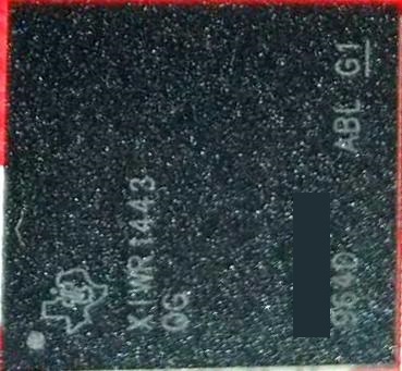

When I attempt to flash a binary that should be compatible with this radar according to the directory structure, I get the error shown below. What do I need to do differently?
It doesn't work no matter what image slot I place the binary.

[1/16/2019, 8:47:26 AM] [INFO] Cortex_R4_0: Checking file C:/ti/mmwave_sdk_02_01_00_04/packages/ti/demo/xwr14xx/mmw/xwr14xx_mmw_demo.bin for correct header for AWR1443.
[1/16/2019, 8:47:26 AM] [INFO] Cortex_R4_0: Header of C:/ti/mmwave_sdk_02_01_00_04/packages/ti/demo/xwr14xx/mmw/xwr14xx_mmw_demo.bin file indicates it is not a valid file to flash to AWR1443: 0x5254534d
[1/16/2019, 8:47:26 AM] [ERROR] Cortex_R4_0: !!! Aborting flashing of specified files!!!
