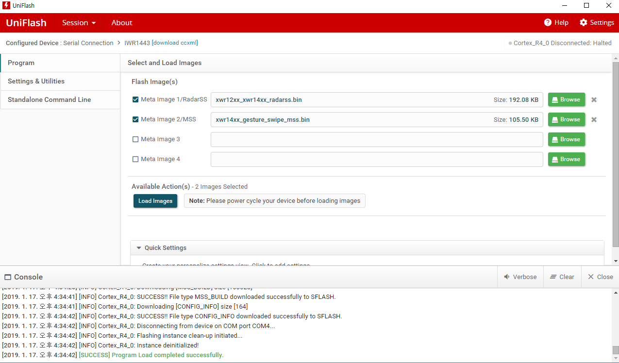

I used IWR1443BOOST ES2.0 EVM.
I have MATLAB v2017a
I installed SDK 1.2, MATLAB RUNTIME(9.2), CCS v8, Uniflahs v4.5 and industrial Toolbox 3.1.1
I successed Uniflash
As you can see in the picture, the load was successful. Then, I removed jumper(SOP2), connected jumper(SOP0)
I want to start GUI(Gesture Swipe)
I ran gettrue_recog_swipe_gui.exe in the instustrial file, but it did not work as shown below.
I'd appreciate it if you could tell me how to solve it.

    Are you able to run the SDK out of box demo without issue?
    It appears that the Matlab GUI is not able to connect to COM ports. Please make sure you don't have any other mmWave visualizers or GUI open and that Uniflash is also closed. Power cycle the board and then try running again.
