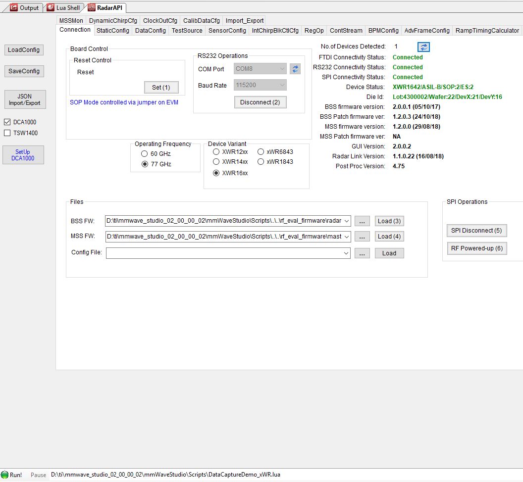

    I follow the directives found in the “DCA1000EVM Quick Start Guide” document:

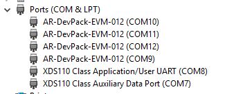

    1. Device Manager shows:
    2. mmWave Studio 2.0.0.2 is running in Administrator Mode in my Windows 10, 64 bits Operating System.
    3.I completed the Connection TAB

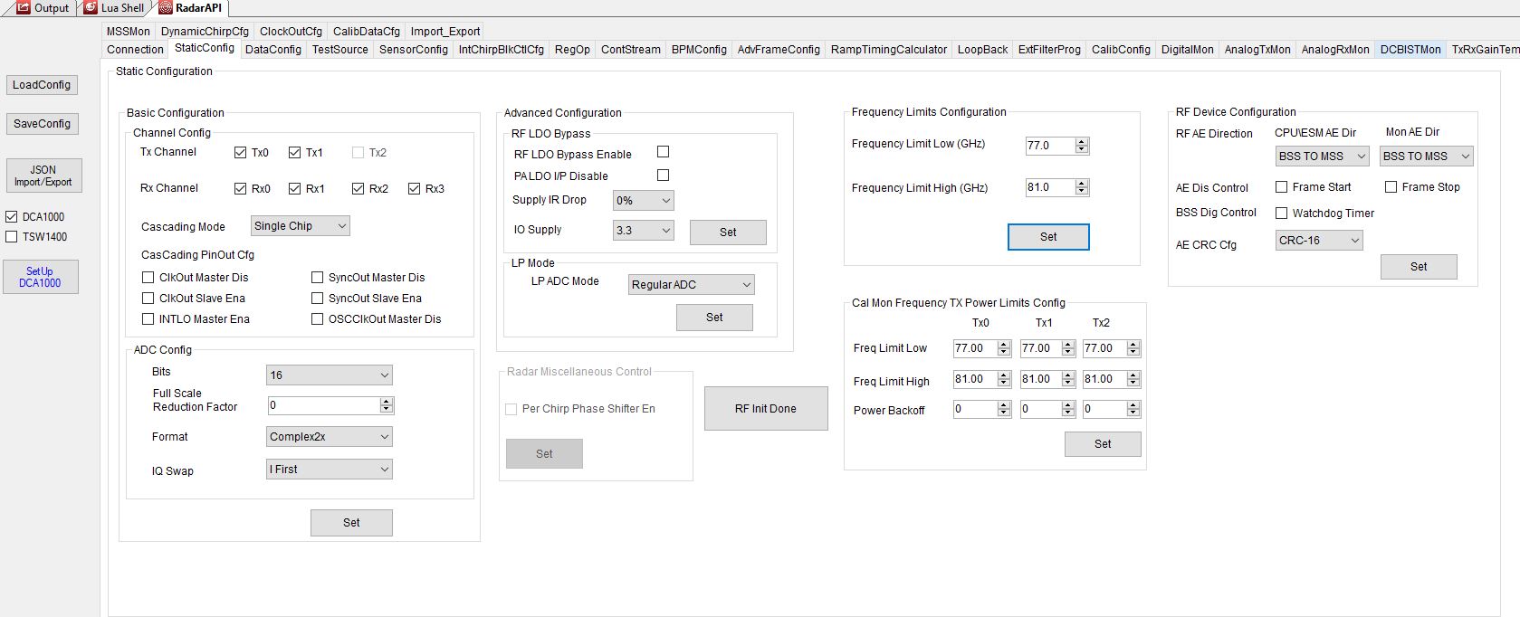

    4.I completed the StaticConfig TAB as guided by the focused set button.
    ADC Config, LP Mode, RF Init Done, Frequency Limits Configuration.

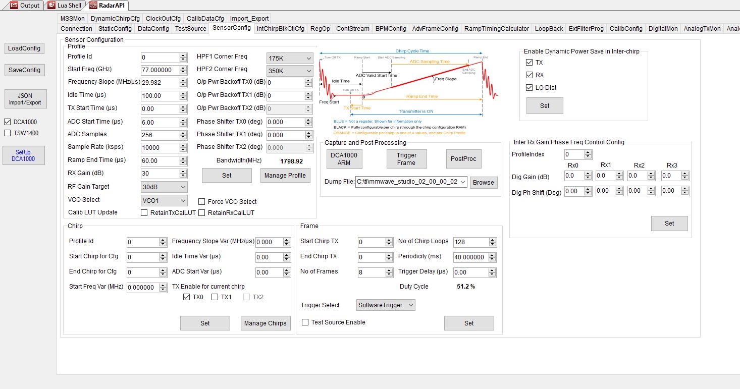

    6.I completed the SensorConfig TAB
    Profile, Chirp, Frame

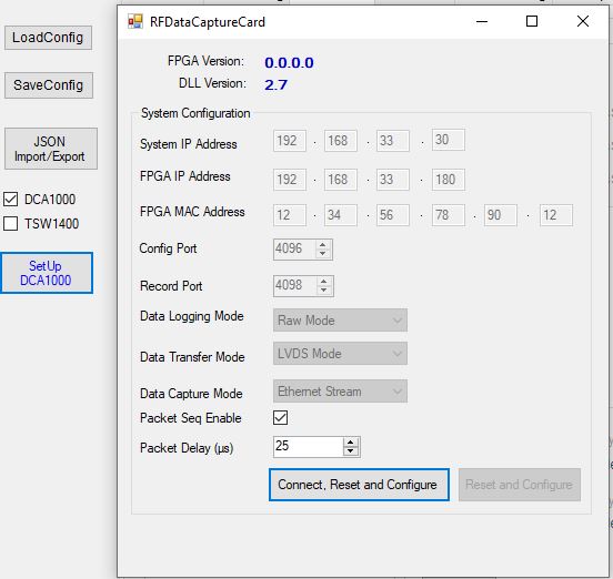

    7. I pressed the Setup DCA1000 button
    7.1 In the RFD Capture Card popup window y pressed Connect

    This sequence is correct. After this, please click the "DCA1000 ARM" button, and then the "Trigger Frame" button in the SensorConfig Tab.
    This will start framing and acquire data. After this has completed (a few seconds including time needed for data transfer), press the "PostProc" button and wait - this will bring up the visualization window.
