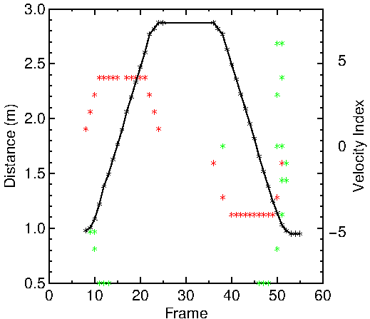

I was examining the detected object and range data for a moving dihedral reflector (single point scatterer).  Attached is a range image for one frame.  It shows an isolated scatterer with the peak value and range information from the detected object listing plotted with red x's. This appears to be okay.  My dilemma is that the velocity reported for each detected object is not consistent (in this case the object is moving away). Shown below is the object data listing for the give frame.   I would have expected the same index for each object.  I have included the configuration file too.  Can you please provide me with advice on how I should configure the sensor so I can obtain more reasonable velocity data, i.e., the same velocity index value?

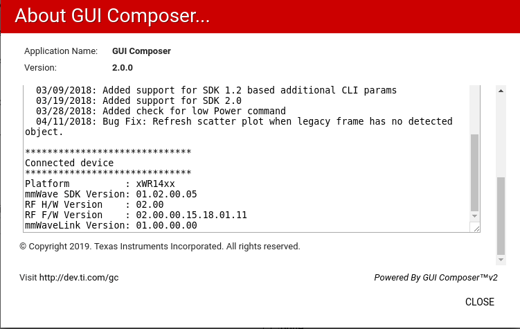

    Hello Allen,
    Can you provide which software & version you are using for: a) the mmWave device b) data visualizer/logger?
    Amanda
  • Hi Amanda,
    Thanks for the quick response.
    I will not be able to provide the exact details until Friday morning.  I am using a D3 Engineering Sensor Starter Kit with a IWR1443 chip.  The gui is the mmWave Demo Visualizer Ver 2.0.0, SDK Ver 1.2.0.5 (from memory).  I can provide the exact information from the About tab tomorrow.  I should have the default xwr14xx_mmw_demo_mss.bin load.  Is there a way to query the part to verify the load?

  • Amanda,
    Attached are some screen shots (four) for the About information which should document the configuration I have.  The bin files used are
    bytes
    196692 xwr12xx_xwr14xx_radarss.bin
    117580 xwr14xx_mmw_demo_mss.bin
    Al

  • Hi Amanda,
    I did use your link to acquire the version of the visualizer that  "should" have the cvs capability.  I down loaded is since my environment does not have internet access.  I was given three options.  Two were obsolete so I the the current version of 3.1.
    Anyway I plotted some data for  you.  This should demonstrate that I am recovering the velocity data correctly.  The attached graph shows the distance of a dihedral reflector moving along a track at ~2 m/s.  First it moves away and then returns.  The distance is shown in black with asterisks indicating the actual values.  These were obtain from that range data. Plotted in color are the velocity values obtained from the detected object data. The red asterisks are the realistic values showing where the dihedral is accelerating and de-accelerating to the terminal velocity of 2 m/s.  An indice of +/- 4 corresponds to a velocity of 2 m/s for the configuration values.  The green asterisks are the erroneous values.  All velocity values had large peak values associated with them in the detected objects array.
    If I were recovering the data improperly, I doubt I would have been able to have values that would be consistent with the motion of the dihedral.
    Please advise.
    Al

  • Hi Amanda,
    I had posted some material a few days ago but I guess an error occurred since I do not see it.  I did use your link you provided to
    obtain a copy with csv capability.  Since I do not have an internet connection where the hardware is, I downloaded a copy from the pull
    down tab.  It directed me to another page with three versions.  Two were obsolete so I acquired version 3.1 which I used but I saw no csv
    capability.  I see that the online version is 1.1.1. Since acquiring this version to demonstrate that I am not making an
    error in the data conversion did not work, I took two other approaches to demonstrate that I am not reading the hex file improperly.
    First I found the section of the output file in a hex editor and circled the velocity values and showed the ascii values as shown in the attached
    image.  These ascii values are the same as I reported earlier.
    Secondly, I plotted the data in a hopefully convincing manner.  As I
    indicated, I am moving a dihedral away from me, stopping and back to me over a ~3m length.  The constant velocity is ~2 m/s.  Attached is a
    graph of the dihedral distance from the sensor plotted with a black line and with asterisks at each sample point.
    The velocity data is plotted with colored asterisks.  The red asterisks is data I can believe.  It shows the dihedral accelerating
    to its terminal velocity and then and near the end of the track, it slows down to a stop.  The process is repeated for the return trip.
    The green asterisks represents data that appears to be erroneous.  If I am not properly converting the binary data, I believe that none of
    the asterisks could be correlated to the dihedral motion.
    I have plotted other frames too.  They also show erroneous data through out the frame.
    In review, I think I have demonstrated that the original data I presented is an accurate rendition of the ouput data and I have
    plotted this data in a meaningful way for review.  Your thoughts?
