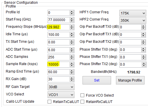

  • Cousino,
    So if I use the default configuration in Radar Studio:
    Slope (MHz/us): 29.982
    Sample Rate (ksps): 10000
    Then the maximum range of the radar will be 49.995(m).
    Where 299792458 is the speed of light.
    Is that correct?
    Thank you in advance for your response.
  • Your calculation looks correct. On your Nyquist question, it is a natural question from the training material which does not go into details and this kind of question keeps recurring on the forum. A good response is at  There is also an application note (see section "DSP requirements") :
