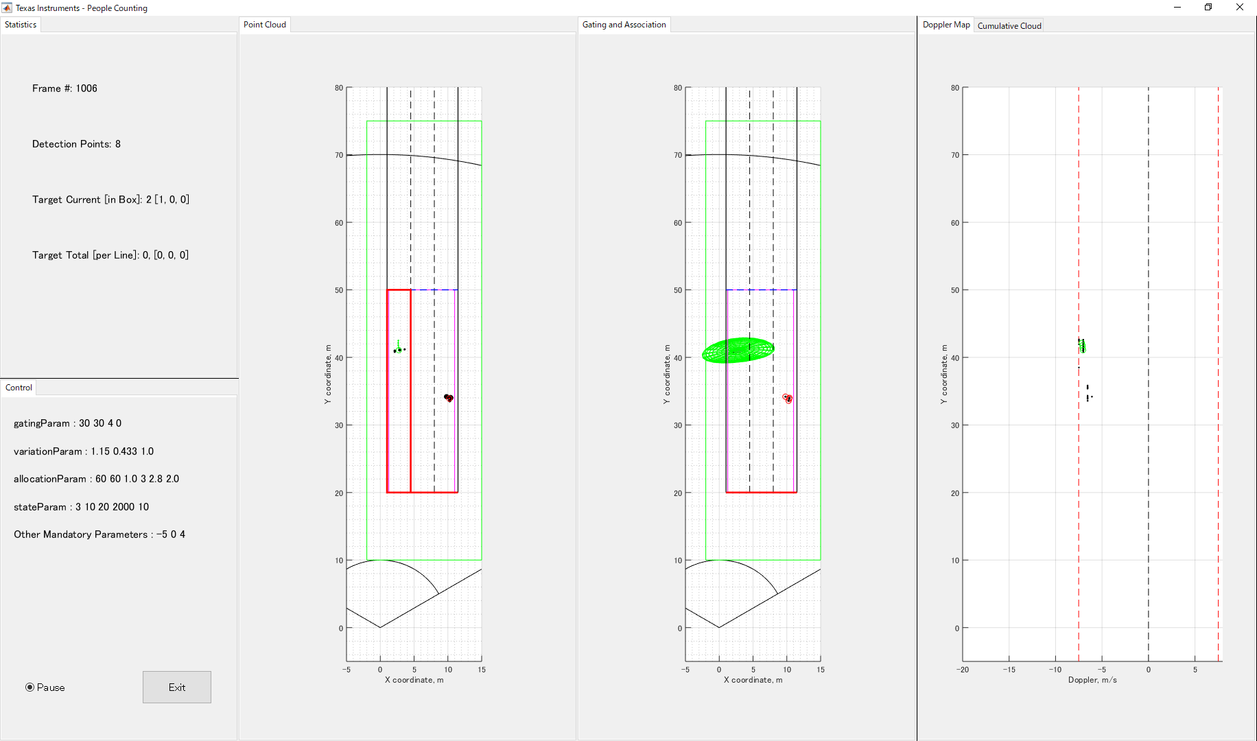

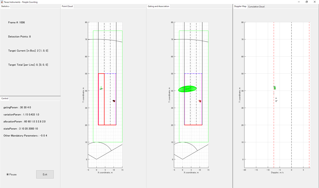

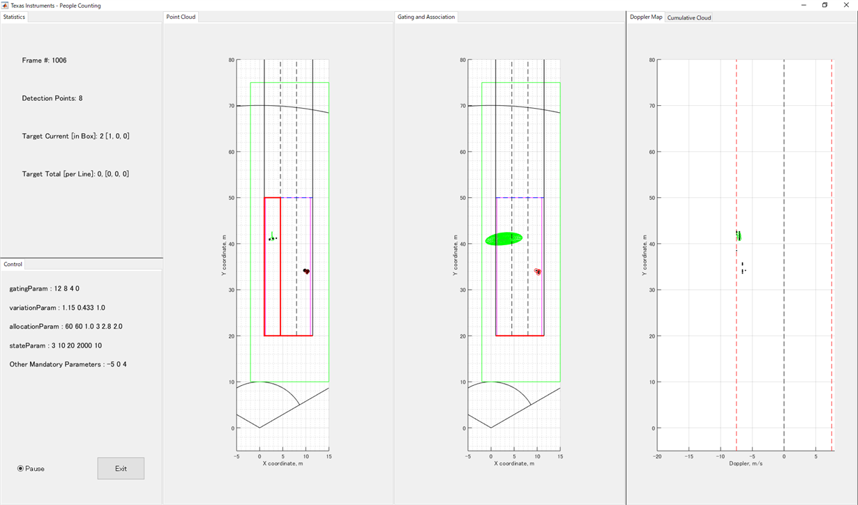

  • Hi Justin.
    Thank you very much for your reply.
    We will attach the tracking result (movie file created with tm_genvideo) before adjusting parameters, so please see there.
    The gating parameter at this time is "gatingParam 12 8 4 0".
    In my understanding, in this parameter, the bubble should fit within 8 m in length and 4 m in side.
    However, it is clear that the width is over 4 m as shown in the figure below.
    Is the understanding of the gating parameter incorrect?
    I confirmed it by setting the gating parameter to "gatingParam 30 30 4 0".
    I expected the bubble to grow longer in the vertical direction, but it remained sideways as shown below.
    Why does not it grow longer vertically?
    Other questions are as follows. Please refer to attached movie file.
    - With 1018 frames, the red bubble is divided into red and light blue bubbles. It is strange that a light blue bubble occurs. Which parameter will be modified to improve this?
    - Even in 1055 frames, the bubbles are separated in the same way, but it is inappropriate to separate them.
    Thanks.

  • Former Member
    0 Former Member in reply to koji fukumoto
    Hello Koji,
    Please keep in mind that the gating parameters are maximum limits not minimum limits. Therefore if you set to a very large value it does not mean that the limits will necessarily stretch to the limit. This will depend on the dispersion of points.
    Amanda
