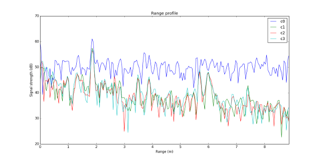

We ported our software to one of them (we previously used ES2.0 boards), but we couldn't make any sense of the data that we collected. After lots of debugging, we noticed that the signal from the first RX channel looked very suspicious. When we tried the second board, it worked just fine. This seems to confirm that there is problem with the first board.
To illustrate the issue, I've made some range profile plots for the 2 boards. The first board gives me something like this:
The signal of the first channel (c0) is significantly higher that of the other channels over most of the range. Moreover, the value does not seems to decrease with distance, as one would expect.

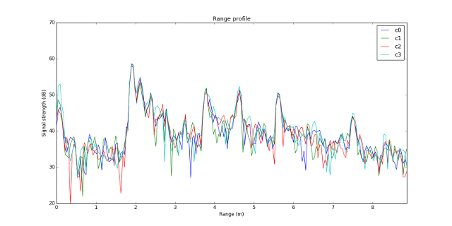

The second board gives me this result:
Here the signals for the 4 antennas are much more similar, as one would expect.
Is there anything that could explain this behavior of our first board, other than a hardware issue on the first channel? Or is the board defective?

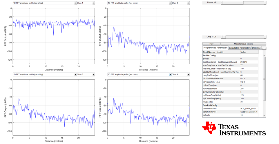

    If you have the DCA1000 then you could also use the mmwave studio tool to capture and process the data. That way we can isolate the HW/board with a pretested capture and analyses tool. Suggest you try that with the faulty boost EVM you have.
    Vivek
  • Hi Vivek,
    I was able to get similar behavior through the mmWave Studio tool (using default settings):
    This seems to confirm my suspicion, isn't it? The signal of the first channel is way different from the other channels.
    If you also conclude that the board is defective, what would be the proper procedure to have it replaced under warranty?
    Eddy
  • Hello Eddy,
    You are right, there does seem to be unexpected behavior on the CH1. Could you help check one more thing, is the behavior same across all chirps? You an scroll across chirps using the "chirp 1/128" bar in the plot above to view the FFT for other chirps as well.
    Vivek
  • Hello Vivek,
    there is no meaningful difference between the chirps - CH1 stays at the same high level.
    Eddy

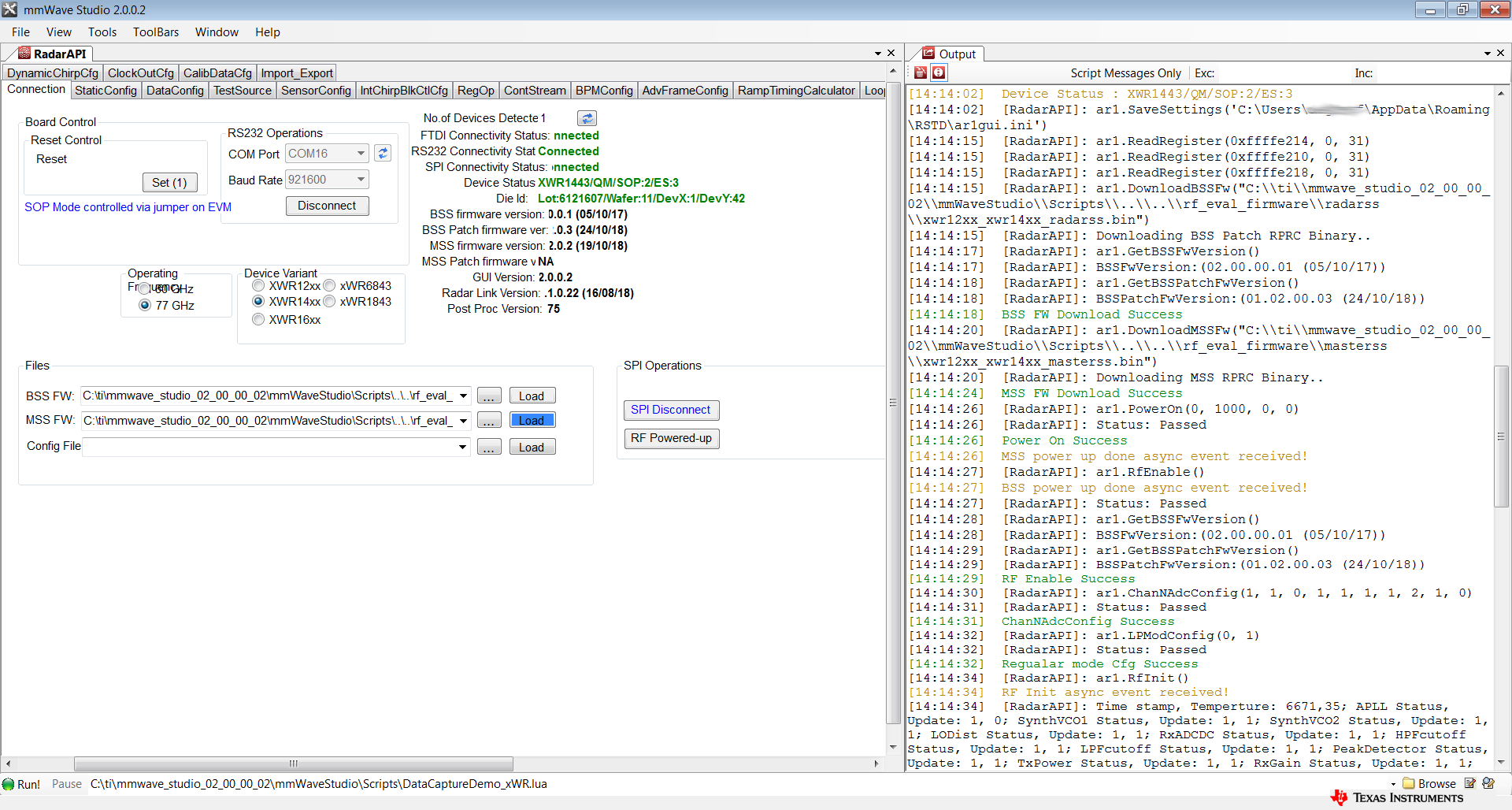

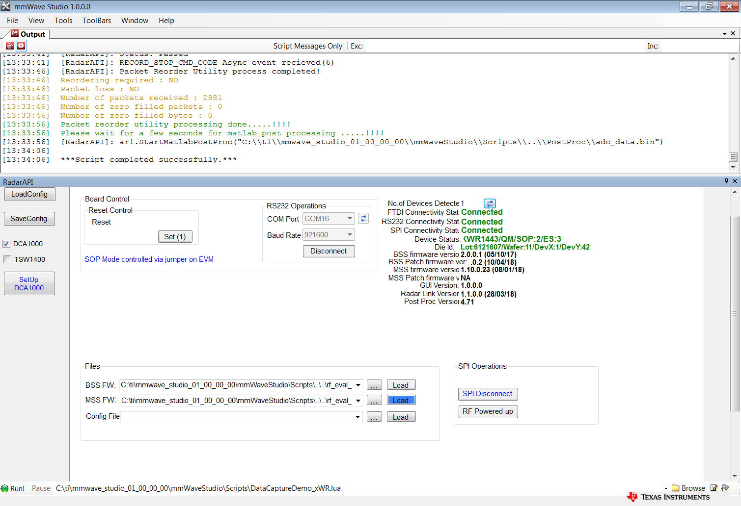

    Thanks for the confirmation.  If you can share a snapshot of the mmwave studio connection window after you connected the RS232 and downloaded the BSS/MSS firmware it would display some of the device and FW details.
    Thanks and regards,
    Vivek
  • Hello Vivek,
    below you can find some screenshots that I've made with mmWave Studio 1.x and 2.x. Unfortunately, some of the firmware versions aren't entirely visible due to a layout glitch (in the second picture, you can also find the BSS firmware version in the log at the side).
    I've verified that the incorrect behavior is present with both versions of mmWave Studio. Moreover, as I explained initially, we have bought two identical boards, and only one of them is having this problem. A software issue is therefore highly unlikely.
    Thanks and best regards,
    Eddy
  • Hello Eddy,
    Thanks for sharing all the information clearly. It does look like a defective board.
    Could you contact your local TI sales representative to initiate a return of this board?
    Thanks and regards,
    Vivek
  • Thanks for your help, Vivek.
    We'll do that.
    Eddy
