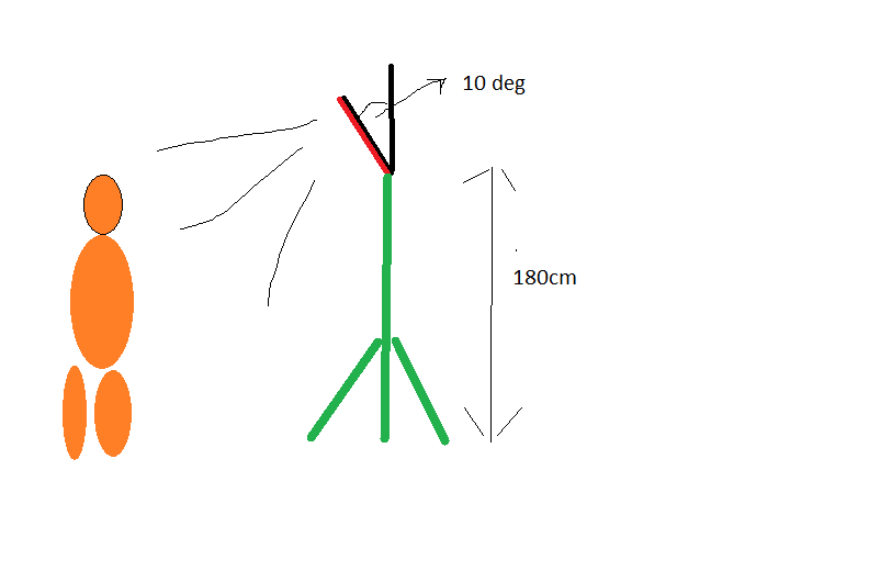

I've mounted the EVM on 1.8[m] tripod, tilted downwards with 10 degrees (as appears in the documents)real world coordinates:
evm @ x=0 y=0 z=1.8
myself @ x=0 y=3[m] z=1.8(top of the head)

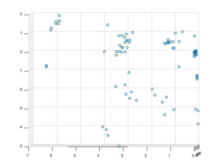

When recording my self on the scene  I get the attached readout.
Column 2,3 4 are x,y,z.
Therefore when examining the data I see that the z values lay between -5 to 2 meters.
Anyway, my height is 180 [cm[ as well, and according to the 3d plot ,I seems that my z points are at one meter above the evm
Meaning that I'm 1.8+1=2.8 [m]
Can you explain ?

  • Hi Gil,
    Sorry for the delay. See Diagram Below:
    Since the sensor is tilted down 10 degrees, the point where Z = 0 is not at your head, it is about 0.5 meters below your head - so roughly 1.3 meters above the ground.  So given perfect angle accuracy, the Z coordinate for your head should be about 0.5 meters.  However, with the antenna configuration on your device, the angle accuracy is about +-12 degrees. (See this post for more on angle accuracy.)  Anyways, this means the measured angle could be anywhere between ~-2 and 22 degrees.  At 22 degrees, the Z measurement is about 1.2 meter.
    With a different antenna pattern, you can get better angular resolution and accuracy. For example, this configuration gives accuracy better than +- 3 degrees in the azimuth.
    Let me know if this clears everything up.
    Justin
