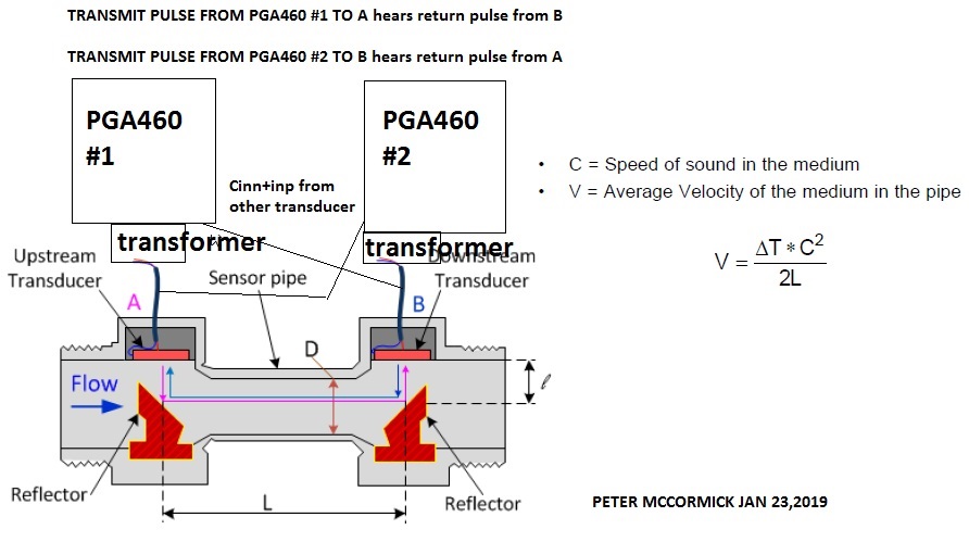

  • Akeem, I think this might work.  How accurate is the PGA460, picoseconds or microseconds?
    Below is a simple diagram from your TDC documentation but it uses 2 PGA460.  We fire 1 PGA to measure time of flight downstream then the other PGA to measure upstream.  The inputs are tied to the other transducer.  The PGA reads the other transducer as shown attached.  This is much simpler than all of the TI TDC concepts as far as I can tell.  Maybe it is a crazy idea.
    Thanks, Peter
  • Hi Peter,
    The PGA460's ADC operates at 1MHz, so the finest available resolution is 8-bit sample output at 1us per sample. If you use the USART (SPI) mode, you can also get a 12 bit sample output at 2 us per sample. Alternatively, you can also capture the AFE output at the TEST pin for greater resolution, but you won't be able to utilize the benefits of the DSP.
    Your biggest challenge may be finding a compatible transducer for flow metering. If I recall correctly, the TDC typically uses a 1MHz for this type of application, while the PGA460 is limited to a maximum driver/receive frequency of 480kHz.
