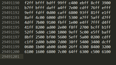

I have set up IWR1443Boost with DCA1000EVM and captured some data, the post processing tool in mmwave studio showed that there are 300 frames, each frame 128 chirp loops, and each loop 3 chirps (Tx1, Tx2, Tx3), for each chirp, 256 samples are collected. There are four receivers, and I think that the total length of the raw data should be 2bytes*2(I,Q)*4(4Rxs)*256(samples)*3(3Tx)*128(chirp loops)*300 = 471,859,200 bytes. However, the bin file (adc_data.bin) generated was 547,688,960 bytes, so I do not know how to load the raw bin file. Could you please help me with this?
Thank you!

  • Peijun,
    Sorry for the delay, from your log i was able to reproduce your setup and I do not see the discrepancy.
    Below you can see the end of the .bin file after the post processing has been done.
    There are 29,491,200 (lines) * 16 bytes = 471859200

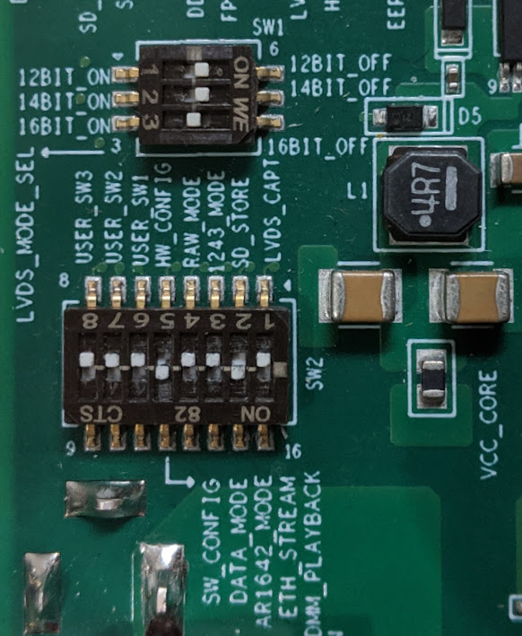

    Verify these settings on your DCA1000
    Let me know if this does not solve it.
    Alex
  • Dear Alex,
    Thank you so much for replying.
    I checked my DCA1000EVM, and the 6th switch of sw2 is different from your setting. I will try again tomorrow with the settings you provide, and will let you know if it works.
    Thank you!
    Peijun Zhao
  • Peijun,
    SW2.6 is a "dont care" in this case, OFF loads data from EEPROM, ON loads data from FPGA, Unless you have modified the EEPROM it loads the default. in simpler words, EEPROM = FPGA, unless EEPROM has been modified.
    Try wireshark and verify the amount of data.
    You might also want to try a very simple chirp configuration, 1 frame, 1 chirp, 1 RX and 1TX, and verify your output.
    Alex
