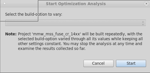

I have been examining optimizing a program for the iwr1443 sensor.  I do not get any advice notices during compilation regarding optimization settings .  I have tried to use the optimization analysis tool.  When I launch the tool, a window to set the build option variable is blank.  How can I set the option to use the tool?  I am using ccs 7.4.

    By optimization tool, I assume you're referring to CCS Optimizer Assistant. Are you compiling a TI provided lab example? If so, which one? You're correct, that the optimizer assistant builds the code with globally applied optimization settings. You can apply optimization settings to individual files by right clicking the file in CCS project explorer and selecting build settings to open the file specific build options Window. The following Wiki page provides an overview of the Optimizer Assistant:

    Thank you for the reply.  Yes I am referring to the CCS Optimizer Assistant.  I have modified the TI demo example for two different applications.  During my development, I would get Advice notices for optimizing.  I am done with the development but I get no notices now, which might be good.  I have tried to run the direct method but my pull down selection is gray out (see attachement).

    I imported my final two projects into a new CCS workspace, did a clean and rebuilt both.  No advice notices and still no build varying options in the selection box.  The lab is the 14xx SDK Demo. I am running CCS  Version: 7.4.0.00015 .

    I tried this on my Windows based CCS installation (from your snapshot, it appears that you are using Linux/MacOS so not sure how it behaves on that) and here's what I found. If you already have optimization enabled in the project build settings, the optimizer assistant dialog can come-up empty. However, even in this case, I found that the optimization advice was already present in the Advice window as shown below indicating that the optimization analysis was already done for this program based on the selected optimization settings.
    Here's what I would suggest:
    1. Start in a clean workspace and import your project using the projectspec. Do not copy the pre-imported project from the old workspace.
    2. Turn off optimization under Project Buld Settings -> Build -> Arm Compiler -> Optimization as shown below and save the project.
    3. Open Optimizer Assistant.
    If this doesn't help, I would suggest you to post this in the CCS forum given below as this is a CCS specific issue:
