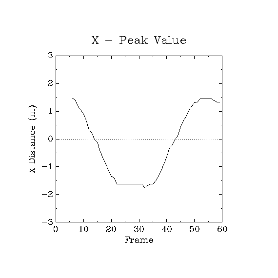

I thought I knew what was meant my angular resolution based upon a number mmwave documents I examined but after taking some measurements, I found that I need some clarification.  I ran the standard mmwave demo application using 2 transmitter and 4 receiver antennas except that I increased the cfar threshold to 4000.  I collected the detected object data when a dihedral moved across the the field of view and back again.  I was  expecting to observe a "digitized" variation in x since the resolution is suppose to  be 15 degrees.  Instead, I observed the following:

2. When I selected the X and Y values for the detected objects based upon the largest PeakVal, I saw a very smooth variation in x as shown in the attached image.
a. Can you tell me why the x variation was so smooth when I thought the angular resolution was 15 degrees?  The field of view was +/- 25 degrees.

  • Hi Allen,
    So just to clarify, Angular Resolution (similar to range resolution) is the difference in angle required for the radar sensor to distinguish two different objects. It IS NOT a measure of accuracy.

  • Hi Akash,
    Thank you for your response.  I would like to clarify my first question.
    I attached an image showing the x variation from the detected objects algorithm.  It was for a corner reflection moving a distance of ~3m.  The total field of view was -25 degrees to +25 degrees of view.  I had expected to get a curve with poor positional resolution since I thought the angular resolution was 15 degrees, so 50/15=~3.  The curve I showed was very smooth.  What is the range of the x,y coordinates in the raw output of the demo program?  What controls the resolution?  I thought is was the number of virtural receiving antennas.
