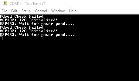

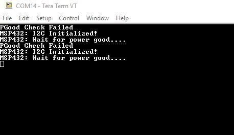

I am running TIDEP-0091 with V3.0 of AWR1443boost and msp432 boards but I am not getting any response on teraterm. When I try running in debug mode, I am able to get a response from boost board. When I just connect the MSP board to tera term, I am able to get the following response, which indicates the firmware is uploaded:
When I combine the two boards, I get no response and I just get a blank screen.
1) I have made all the modifications except for R90, R100, R103, R117 which are for LEDS. Are these necessary?
2) Since I am on V3.0 of boost board, do I need to make any firmware modifications? I noticed, it comes with LP87524J instead of LP87524B.
3) On slide on 17, it says to connect NRST (SW2) to J5-7 but on slide 18, it shows J6-7. Is it supposed to be  J6-7? I did connect to J6-7 but have not tried J5-7.
I am just uploading the default firmware. Please let me know if any other information is needed.
