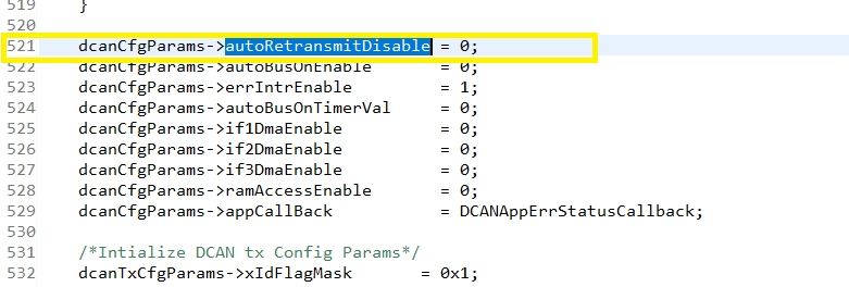

  • Hello ,
    Can you please check if the "autoRetransmitDisable" is being set in your code?
    Please make sure that the re-transmission are enabled in the code when using multiple message objects so that the re-transmission are attempted and transmissions are successful.

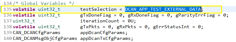

          非常感谢您的回复。 “autoRetransmitDisable”已设置为0; 我正在调试SDK提供的Dome项目(..:... \ sdk2000004 \ mmwave_sdk_02_00_00_04 \ packages \ ti \ drivers \ can \ test \ common \ mian.c):
    代码更改如下:
    testSelection = DCAN_APP_TEST_EXTERNAL_DATA;
    dcanCfgParams-> autoRetransmitDisable = 0;

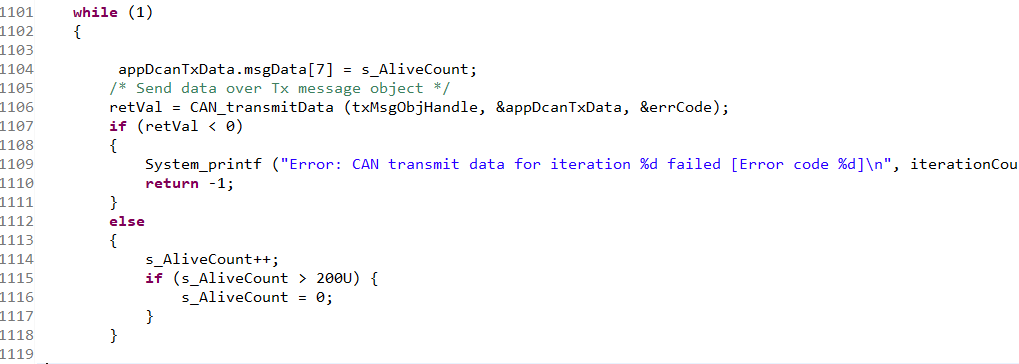

    验证数据是否连续发送的机制是:

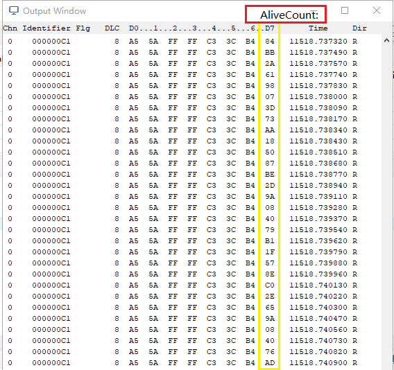

    将“AliveCount”添加到发送数据,并在每次成功发送CAN数据时将“AliveCount”增加1. 详细的可见图片
    在此更改之后,当使用接收设备接收数据时,发现“AliveCount”不是连续的:

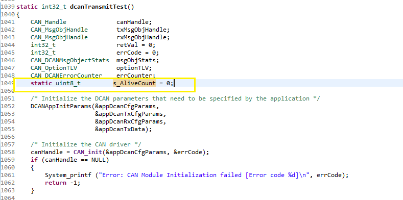

  • Hi Leiyang,
    Could you confirm if you have iniitalized the s_AliveCount = 0  and the type of s_AliveCount?
    -Raghu
  • Hi  Raghu,
     Thank you very much for your reply.The variable s_AliveCount is defined as follows:
    Apart from the above changes, I'm sure there are no other changes.
    Any thoughts you may have could be helpful!
    Kind regards,
    Leiyang
  • Hello Leiyang,
    Could you check by putting a delay between the transmission?
    Include a Task_sleep(1) in between CAN_transmitData() .
    -Raghu
  • Hello Raghu,
    I know that the discontinuity of s_AliveCount will be improved by adding sleep (1). But the key problem is the return value of the CAN_transmitData() function, which can not accurately reflect whether the CAN message is successfully sent. When the CAN message is not sent successfully, the return value of the CAN_transmitData() function is still 0. When CAN data needs to be sent quickly, it becomes uncertain whether the CAN message is successfully sent.
    -Leiyang
  • Hello Leiyang,
    Using the delay is the current workaround for the issue. We are looking to address this issue in the next version of the SDK.
    Raghu
